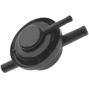

The fuel vaper in the tank has alwasy bean there, The vaper is routed to the charcoal canister from there the canister purge valve allows the vapers to enter the TB, by the way this is an $18 part . THe computer monitors this and tells when and where to allow the canister to purge. Check your haynes manual its there.
Now I'm not sure if this is the fix for your problem. The pump wine gets loader becouse the added presure in the tank.
I've bean chasing this problem for some time now looking enywhere and everywhere replacing all different parts. BUt in my case a PO had removed the charcoal canister and purge valve.
OF course I'm now looking for a charcoal canister. Can't buy new. Unless someone can tell me how to go with out one and not have this problem

What is an 18 dollar part? I couldn't find a solenoid at the parts stores?

Its not a solenoid its the charcoal canister purge valve.
The charcoal canister takes the vapors that have always bean in the tank and allows them to be be compusted in the engine instead of going off into the air. The purge valve helps control when the vapars are allowed ti enter the compustion chamber.
The fuel pressure and the heat that everyone is complaining about here has always bean in our car. every since the government said we could no longer let gas vapors to just go into the air. Emissions control.
What everone here is seeing has always bean there. Something must be wrong then at the point of how the vapors aren't getting to where they need to at the right time.

I don't see why No one is truly lissening here. The tank only vents into the TB so the fuel vapors can be burnt. The problem is NOW FOLLOW ALONG HERE!!!!! its so simple. the vent for the tank goes threw the charcoal canister that by the way is conected to the computer. From there it goes threw a purge valve. BY the way this maybe the broblem piece. Then into the TB. so it can be burned off.
IF there is a clog in the line, A bad charcoal canister or a bad purge valve then You will be having this issue you're discribine.
YES IT IS THIS SIMPLE!!!!

No. There is a secondary pressure release valve on the gas tank to prevent this from happening. Ever notice the short tube with the round valve hanging from the gas tank?
No I'm sory that is not a vent tube, That is a air intake one way filter. Not a vent filter. The EPA states that no fuel vapor is to be allowed to go outside into the air.
Now out fuel tanks are a sealed unit. Thats why we no onger have vented gas caps for our car.
When gasoline is under presure it heats up.And causes more vapors.
( ethenal does not make this worse, But helps raise the boiling point of gasoliine.)
I don't see why no one can see this as the problem, Is it just so simple that some how it doesn't make sence , but it does.
Come one get out your haynes manual its right there plane as day.

I thought the thing hanging off the tank was a check valve. When the tank had so much pressure it opens and allows it to exit. I believe the problem is heat. When my pump is loudest (when the cap has been off) I can put my fingers down in the neck and feel the heat. I guess fuel system modifications are in order. Since guys with fuel cells and aftermarket external pumps have the same problem. It has to be something heating the fuel up front. I'm going to add header wrap, relocate the fuel line thats a inch away from a header tube, heat tape everything, ditch the brackets bolted directly to the hot engine, and add a tranny cooler in the return line.
You're over thinking the problem,
Sorry dude, you are wrong. I have one sitting in front of me right now. It is designed primarily as an intake but also as an exhaust in the event of evap failure. It is a safety device to prevent tank rupture. Its release pressure is higher than the evap working pressure so it is not normally in use but it is easily released buy simply blowing into it. Members have reported driving around with the gas cap off and still their engines died. It is not a pressure issue.

I'm going to try and to explane the solution for this problem. You are all over looking. I had this problem and this is what finally solved it. It is the purge valveinline with the charcoal cannister. It is open. Not closing. Allowing fuel vapors to always enter the TB.
This is Not a heat issue. Take a good running third gen and check the temp of the tank with one that is having the problem The temps will be the same.
The purge valve is supposed to open and close at a certain vaccum pressure to allow fuel vapors to be burnt off.. If the purge valve is always open then fuel vapors will alway be entering the combustion prosses when ther are not suposed to. And the computer reads a to rich condition and leans out the fuel mixture. Thus giving us a vapor lock condition.
I had this same problem And after replaceing the hole fuel system in my car. ,tank, fuel lines, fuel rails, injectors, iac ,ECT. I finally read up on the charcoal canister purge valve and how it worked. I replace the purge valve and haven't had an issue since.
But since none of you believes this couls possibly be the problem. I ask the one broave soul out there to try this simple fix at a cost of less than $20. And give your results here.
Thank you
I hear you. And it is entirely possible that that is the issue for some of the people here. That is not MY issue. How can you explain the drop in fuel pressure when it happens? How can you explain why it doesn't bother the engine until after an hour of running?
Does the engine go lean when it dies? Yes of course, but that is b/c the pressure is dropping, not b/c the computer is doing it. My very last dyno pull the engine was far leaner than the other pulls, right after the pull, the engine died. In full throttle, the computer does not have the authority to lean out the mixture.
With that said, I do have a new purge valve sitting in my pile of new parts to go in. I'm going with the scorched earth policy, changing everything.
Thank you
So what is this $20 part and where can I get it?
He is talking about this guy.
http://www.amazon.com/ACDelco-214-20...3557229&sr=8-2
