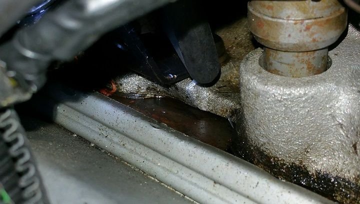

I'm bringing this back from the dead because I finally got around to figuring out my blow-by problem. I took a few pics of the intake gasket on the driver and pass side. On the driver side it looks like I could see a little antifreeze where the intake gasket and head come together right behind the waterneck. On the pass side it looks like the gasket is completely blown out in one area.
There seemed to be a little antifreeze, not much, where the gasket and intake come together.
Gasket blown out with some of the sealant pushed aside.
Here you can see what looks to me where the gasket is blown completely out.
So on this last pic you can see where there is actually some gasket still present.

Is there any way this could be caused by failed head gaskets?
