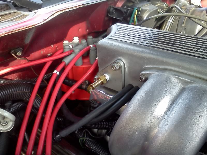

on a quick note the only mod i had to do was drill and tap a vaccum source for the pcv valve... the First manifold does not have a pcv manifold vac port so i just tapped into the side bracket where the egr would be on the FIRST to get my manfiold vac....
