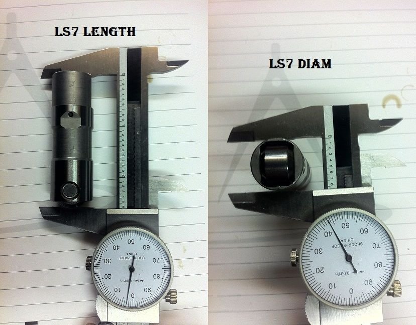

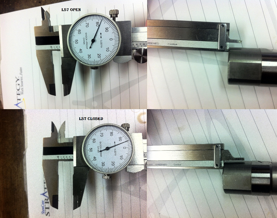

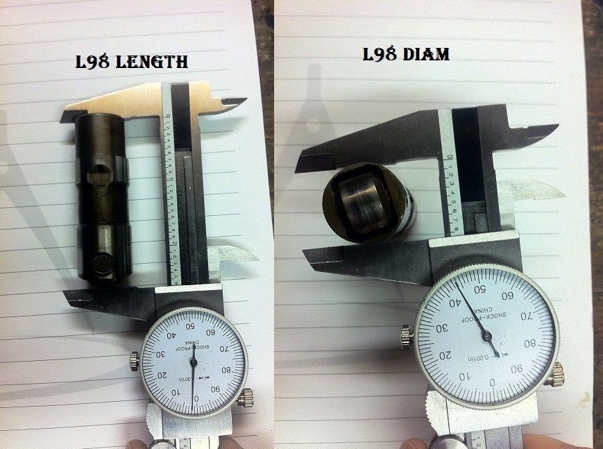

Measured my stock L98 lifters with 215,xxx miles on them vs new LS7 lifters I purchased, wanted to post what I found.
With these measurements, you could also calculate the exact correct preload based on the threads per inch of the rocker stud you are using.

Cup to top of lifter measurements.
L98:
Extended .340"
Depressed .480"
Total movement: .140"
LS7:
Extended .282"
Depressed .495"
Total movement: .213"
All other measurements are the same.
