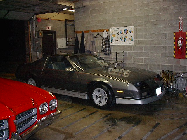

Picture is there just because I felt like it.

I'm really starting to think... just starting with a higher option car would really be the better way to go. BTW I absolutely love the way your car looks! Only thing is the H.O. F-bodys are hard to find in my area, WHY I don't know. I know less were made but still..
