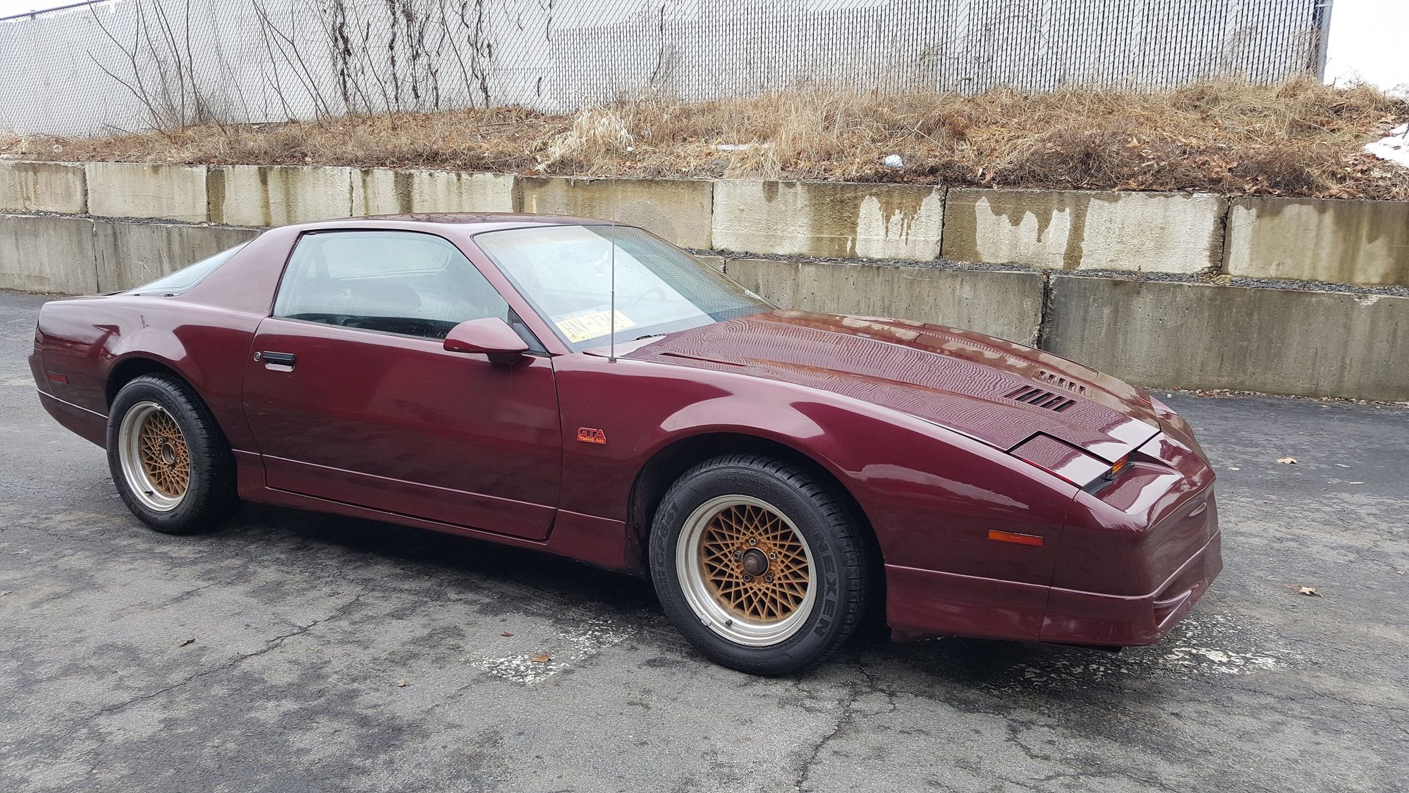

Hi all, I recently bought a 1987 Trans Am GTA, with the L98. This is my first F-body car and my first fun car. I was wondering how entailed doing a tune up would be with this car. I've never worked with a distributor and I've never worked on coils. To my knowledge this car sat for a very long time, as it only has 59000 miles on it. Where should I start with getting this car running like it should? I was thinking plugs, wires, fuel/air filters, distributor cap/rotor cap and PCV. I appreciate any help you guys can give me.

Weclome. Looks like a super nice car! I was in your shoes in February. My 2¢:
