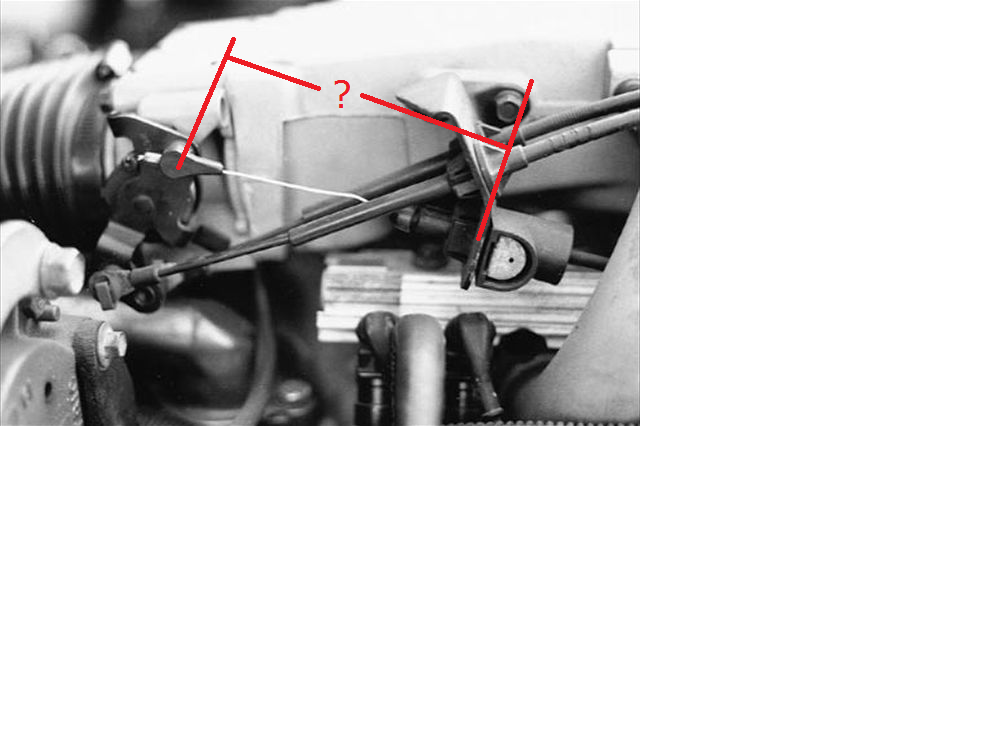

Can someone with factory TPI/700R4 please pull a dimension for me? Basically the throttle cable bracket in relation to the throttle arm. See attached picture.
Much appreciated!

4 7/8 from the tv bracket front to the center of the tb tv stud.

Awesome. Thanks much! (Should have come here first... lol)

Question:
Does it matter what model year the throttle body is? I know late model throttle bodies are different in some respects than early models. Did the change effect the linkage arm as well?

Get the spring dohickey from Sonnax to allow setting it correctly.
Mine likes a bit of tension right off idle but then is over pulled at WOT.
http://www.sonnax.com/parts/2765-tv-cable-corrector-kit
