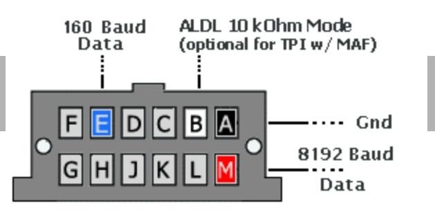

thank you, I asked the po about the serial data wire hes not sure, another thing I'm looking into then I will order the the stuff from moates.net and go that route.

Re: trying to identify if tbi to tpi swap was done correct
You can look at your aldl under the dash drivers side.
It's easy to use a paper clip to release the tab and pull the wire out the back.There maybe a plastic lock piece that needs to be removed first.
You need the $8d adx file for tuner pro rt.
http://www.tunerpro.net/downloadApp.htm
http://www.gearhead-efi.com/Fuel-Inj...Information-8D
