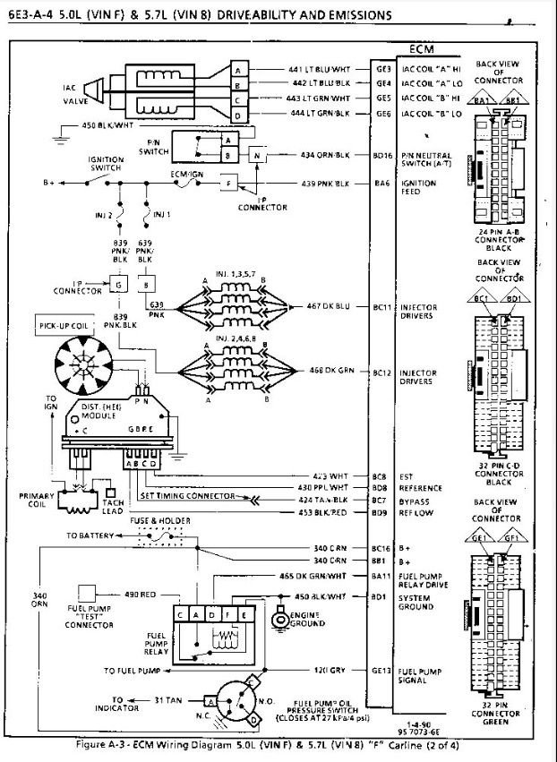

The chip would have to be removed from the piggyback holder with the memcal hooked to the adapter. D8 should be checked for continuity from the icm plug to the ecm. The notch on the chip will be towards the outside edge when returned to its original position.
http://tpiparts.net/1227730_pinout_diagram

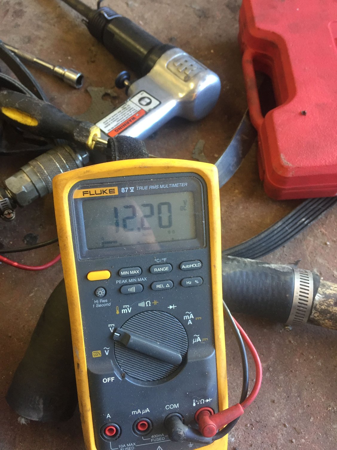

What are the ohm readings on your injectors? Have you changed the injectors out during any of the TPI swaps?
Any open injectors or any out of the 12-16ohm readings unplug and see if you have pulse then.
Saw your other post, so all of your injectors are unplugged currently?
Also check what you TPS voltage is reading, anything over 4V during cranking will put the computer in clear flood mode.

Check all your powers post 16 link and that the icm connections are in the right cavitys especially the purple/white in cavity c.

I dont reremeber if i did switch injectors years ago when i first tried getting this set up to run. If i did it would have been more likely from a LT1 do to me having a couple of those motors over the last 10 or so years.
I did ohm them out and it was 12.4 and 12.8 and i do have them all unpluged
The TPS 4.42 closed 0.735 WOT

here is the ICM plug

Re: injectors not pulsing
The tps readings are bass ackwards , blue wire to blk wire grey is 5v ref.
From top to bottom blk, blue, grey.
The injector impedance seems low, iirc they should be 15.5-17 or so.
The icm connector looks right the letters are on the other side of the body of the connector.
http://www.iroczone.com/2009/10/adju...on-sensor-tps/
Throttle closed
WOT
This is from one of my stock pile of lt1 parts
A 40# one I have sitting on my shelf I am thinking the injectors I have on the motor is from an LT1
i was getting my readings earlier from the wrong wires
Sounds like you have covered it all for injector pulse. It must be a vats issue. Maybe ecm for less can just send you a new eeprom to replace yours. I would of thought with the eeprom bypassed you would of had a code 41 or 51 but still have injector pulse bypassing vats. Got me stumped what the issue might be.
I think I'm out too haha. At this point it has to be either VATs or a bad ground or wire.
In post #6 Tuned Performance said to check for continuity from d6 &d7 to the ground on the back of the head. Did you do that?
Yeah it's all checks out. I ordered a different chip from hawks motor sports so when that comes I will give it a try

Did you check all the ecm power wires. The ecm can appear as it's on with the check engine light illuminated but without the switched ignition feed (a6) you will not have injector pulse.
Old Apr 16, 2017 | 12:52 PM
bkcamaro's Avatar
Joined: Apr 2008
Posts: 68
From: Krakow
Car: 85 z-28 and 96 z-28
Engine: 383 storker and a 350LT1
Transmission: 700R4 and 4L60E
Axle/Gears: 3.23 and 3.73
Yep 12.2 volts
