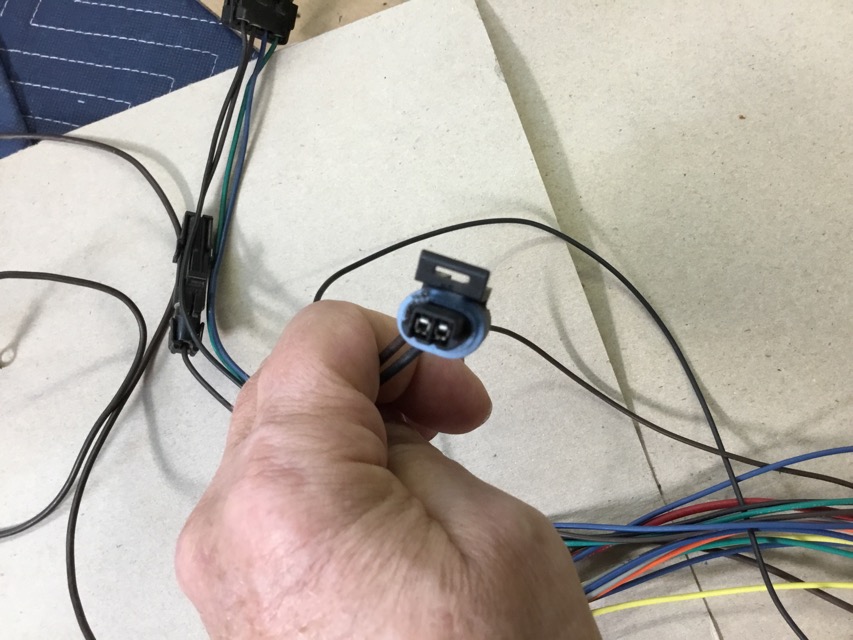

Thanks for all the replies guys.... now on to the next phase. As I said before a wiring harness came with it. That’s the long shot pic. There are a couple of connectors that I am unsure of... The connector in the 2nd goes to...? The connector in the 3rd pic goes to...? And there are individual connectors. Any ideas? I guess this was a no frills wiring harness for a stand alone install?
Attached Thumbnails HELP! TPI, what did I buy? Etc.-5f524f56-ac3f-44b3-95ce   HELP! TPI, what did I buy? Etc.-c9df947e-955a-4ec1-adcd   HELP! TPI, what did I buy? Etc.-4de4cddf-185b-4b8a-a248   HELP! TPI, what did I buy? Etc.-84206613-a106-4dee-9086

Old Oct 1, 2017 | 09:07 AM
Tuned Performance's Avatar
Community Influencer
iTrader: (95)
Posts: 16,937
Likes: 1,019
From: Mile High Country !!!
Car: 1967 Camaro, 91 z28
Engine: Lb9
Transmission: M20
Re: HELP! TPI, what did I buy? Etc.
Cts or mat and distributor connector
http://www.chevythunder.com/199091_c...227727_ecm.htm
