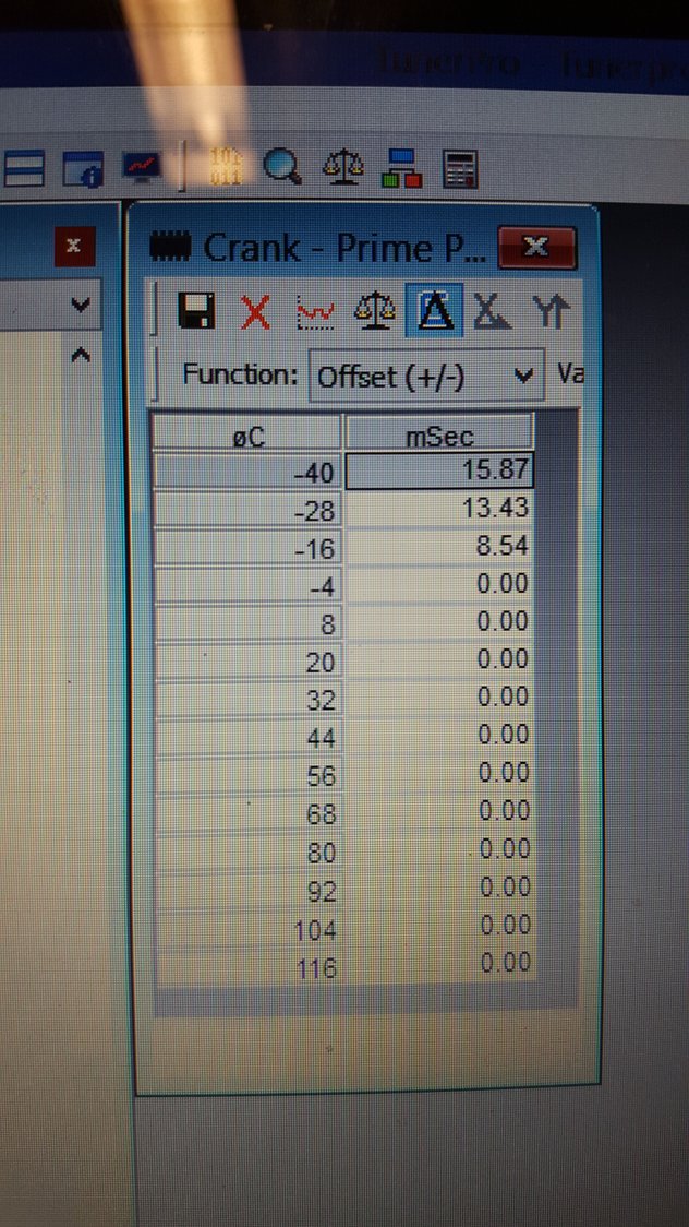

What do you think of this Crank - prime PW table?

Originally Posted by IROC406
I am assuming these numbers are the actual AFR numbers during cranking right?
Yes, those values are used as the commanded AFR for the PW calculation.
