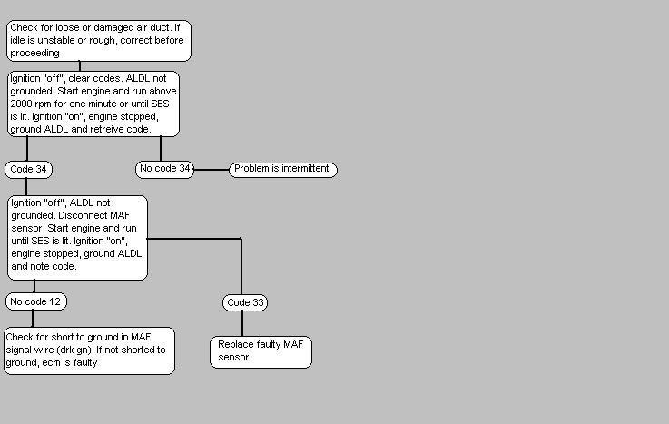

Confirm faulty MAF
From: http://chevythunder.com/

I parts-cannoned for a while thinking the problem was the MAF.
Turned out to be the ECU.
