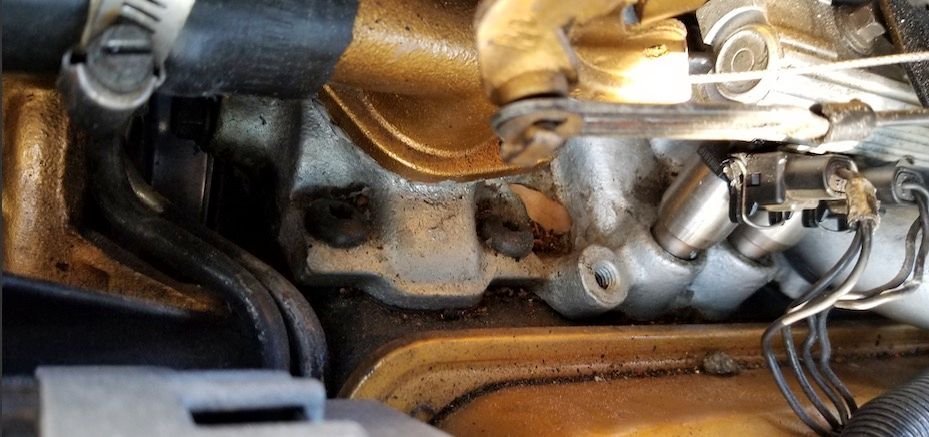

Ok
The compression test is done here are the results
All new spark plugs and wires with .035 gap... New rotor and distributor cap / new ignition coil...
The injector test has me worried
The 2 front passenger injectors make no difference to the idle at all you can leave both disconnected and the car will behave the same.... So it looks like the problem is either the 2 injectors (I was told the injectors were new and they look new) or the wires are not sending signal to injectors? How can I test the cables? how do I know the order maybe there are inverted?
My harmonic balancer looks like this the rubber is not even all the way around is it bad?
Please help

Originally Posted by 1MeanZ
Strong possibility it's a dead cylinder. You could have a bad injector, bad spark plug, plug wire, or low compression on one cylinder.
First I'd unplug the fuel injectors one at a time and see if there is one cylinder that doesn't change the engines behavior when it's unplugged. If you unplug a fuel injector and the engine doesn't respond, there is your dead cylinder.
If you find a dead cylinder, do a compression check and see what you get. If compression checks out OK, put new plugs and wires on it and try again. If you still have a miss with good compression and new plugs and wires, 99% chance you have a bad injector at that point. If you have one bad, you have 7 others close to death so buy all 8 if you have one that's bad and replace them all.
Go here for injectors.
www.fuelinjectorconnection.com
www.southbayfuelinjectors.com
I am ordering these injectors from southbayfuelinjectors ebay store...
https://www.ebay.com/itm/22LB-CORVET...kAAOxyW7tRiH8P
I bought the NOID light to check the injector harness and I get signal on all connectors for the injectors, I also checked the spark with the inline tool that connects between the spark plug and the cable and all 8 cylinders have spark as well...
But since when I disconnect the injector's plugs from both cylinders (in the passengers side towards the front of the engine) nothing changes I think it is safe to say that the injectors on those 2 are bad correct? is there anything else I can do to check?
Thanks for all the help

GD here are some pics of the intake it has a few numbers on it I was not able to find anything about it

More photos... I know the gold paint has to go... I will polish the TPI unit and new valve covers are on the way...

Uh..... it would appear that this is a factory TPI intake.... so I can only assume that the heads are in fact NOT Vortec heads. The plot thickens......
You should attempt to determine which heads you have.... remove a valve cover and find the casting numbers.
