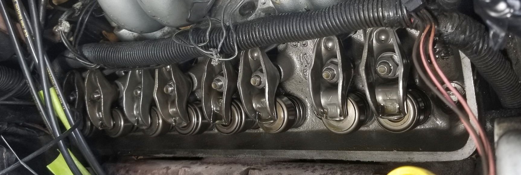

Here are the photos of the heads without the valve covers... They look new as well nothing loose
Passenger side

Those are factory heads for your car. TPI L98 heads. They must have realized the intake wouldn't bolt up to the Vortec heads and swapped the factory heads back on (hopefully with at least a refresh).
The ports on the throttle body are just for throttle body cooling,. You can cut them off and shave down the casting to where it's just the IAC portion. Those ports are both unnecessary. You don't need a plug on them.

Glad they kept the 083s much better than a swirl port tbi head to bad they didn’t turn out to be vortecs.
@GeneralDisorder Is a 183 or does that say 193 a tbi head ?
I didn’t see the 083 on the passengers head
Yeah - now that I look at the other casting number.... does it have two different heads? That looks like it's a 193 and a 083......
I have no idea what a 193 head is or what kind of chamber it has compared to the L98 head.
It's starting to look like this is a real mutt.
GD

https://www.thirdgen.org/forums/tpi/...4102193-a.html
thats not good probably a larger cc head compared to a 083.
You would of thought this would of changed the compression results.

Lets back this up just a bit. THIS ENGINE HAS TWO DIFFERENT CYLINDER HEADS. One is a swirl port TBI head and the other is a 083 TPI head. Heaven only knows what pistons are in it at this point, what the compression ratios are, or if they are even all the same bore.
Are both types TBI and TPI heads exactly the same on the visible areas?
Old Apr 24, 2019 | 10:18 AM
  #78
GeneralDisorder's Avatar
Joined: Mar 2017
Posts: 4,255
Likes: 427
From: Portland, OR
Re: 1989 Trans AM GTA - TPI - Vibration up to 2500 RPM (On Park or Neutral)
Casting numbers don't lie. The heads are probably very similar by outward appearance. Maybe differences to the pattern on the front/back - the "casting marks"
But surely this can't be good. Here's some information on flow rates:
http://garage.grumpysperformance.com...t-heads.10579/
While the static compression may be the same, cylinder filling due to major port difference is probably way off. This is probably resulting in different fueling requirements for each bank, and the TPI only has a single O2 sensor monitoring the driver's side bank. It is *assumed* by the ECM that 1/8 of the total MAF airflow is going into each cylinder - that is not the case when you have radically different airflow through different heads.
Monitor your exhaust temps on the passenger side vs. the driver side. I bet you see significant differences indicating different fuel/air mixture.
GD
GD
Thanks GD...
It is just hard to believe someone would do that... what were they thinking...
Why spend the money on a crate engine if you are going to do that..
Hopefully tomorrow I will be able to work on the car... The rep on the auto parts store near me had a similar problem with the vibration and 2 cylinders not firing... He told me to try to replace the ignition module on the distributor.. I will try to do that tomorrow and also figure out what to do to stop the gas leak on the injectors...
