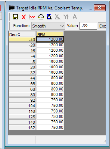

what should the idle be on a 91 manual car?

Old Aug 24, 2019 | 06:59 PM

Re: 91 305 TPI Random Miss and running Rich
^good call! However shouldn’t the idle be set around 650 for tpi unmodded? Anything higher would allow the blades open forcing air in to be compensated for. Thanks for input and correcting anything tuned!
You can always set it to 20-25 iac counts. I think if you try to set the minimum idle speed to 650 you will be ok the iac will compensate for the extra target rpm.
^just realized I thought he set minimum higher. Sorry misunderstood. Yes when warmed up then it would drop assuming the minimum was at 600-650.
