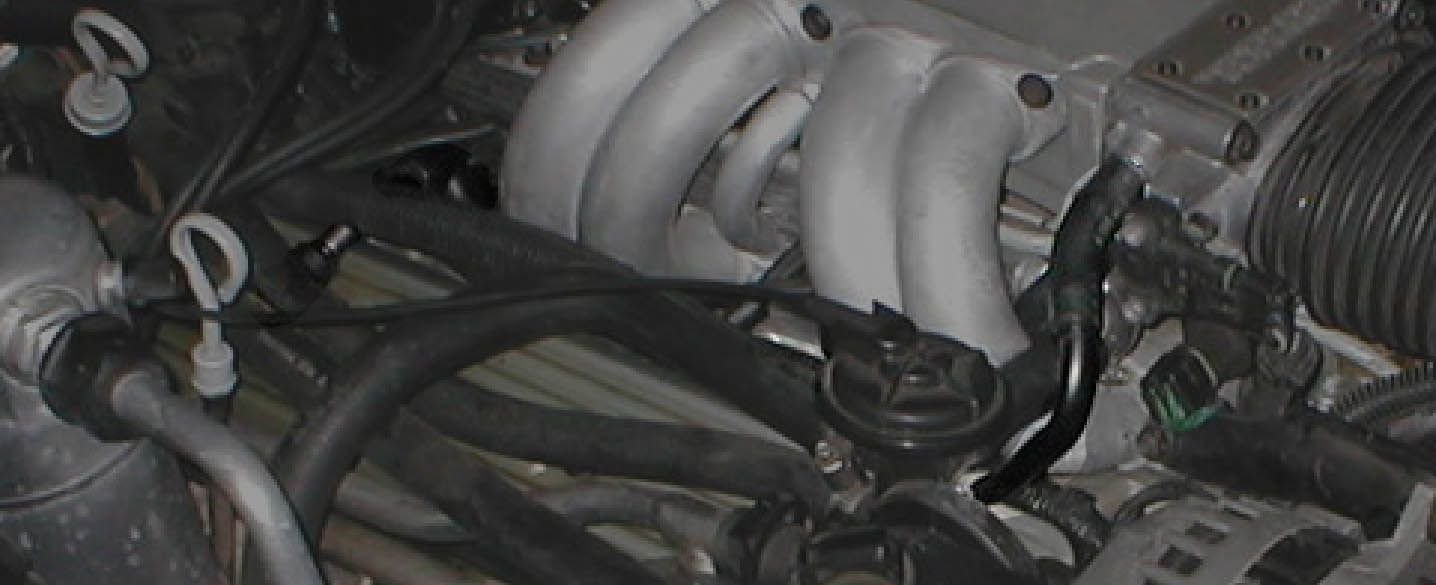

30 min response Drew your on your game today I went looking for pics and most didn't show was different setup - any suggestions where to locate?
Edit - looke what I found

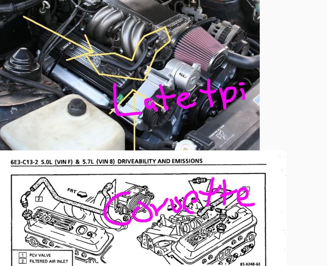

Two different versions on vc one is as shown. The other uses this hose and puts the breather hose towards the firewall.

There are different versions of VC plumbing. Early TPI cars have a hard pipe with a couple rubber couplers and a curved pipe to the rear of the VC. Later cars have the 90-degree towards the front and the short hose. Corvettes are different too. And there are truck centerbolt VCs that use the 1/4 turn oil cap instead of the screw in cap. Makes for a lot of different ways it can be cobbled together wrong.
Should only be one hole in the 90 tpi passenger's valve cover.

Not the best pic, but early TPI are crowded as hell under the hood. Look close and you'll see the rubber elbow grommet near the rear, a curved hard pipe to another 90* rubber coupler, then the hard pipe that bolts to the base below the runners in the middle, up to the front where it turns up and meets ANOTHER coupler to the throttlebody. Needlessly complicated was the rule of the day.
