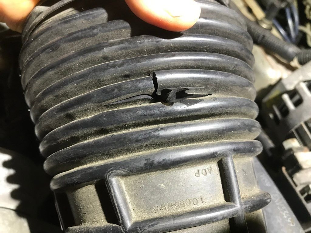

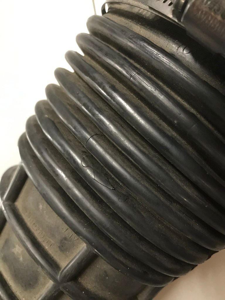

In desperation I pulled the boot between the MAF and TB to see if I could see beyond the TB valves for a rag or something stuck in there by chance, and found the boot torn pretty bad, but it doesn't look like it until it is flexed. My guess is that under more airflow from the engine, the air filter/MAF is being partially bypassed and air is being sucked in through the crack (which probably flexes wide open under mid-high RPMs where I was having the most power loss) and would be my guess as to why the O2 reads lean - as only enough fuel is being put in for what comes through the MAF. I put some black silicone gasket maker and rubbed it into the cracks and stretched it in there, then cleaned it up. Will see how it does tomorrow. Otherwise, I'm at a loss as to what else could be wrong. Where could I get a new one, or are there aftermarket silicone hoses?
