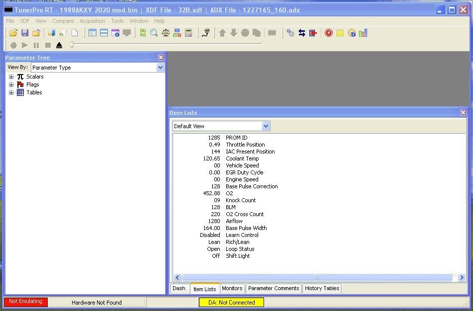

So, about to run over and log this climbing the hill. Do these spec files (adx, xdf) look ok for logging? I just want to make sure I capture all the data you're looking for. I've logged with HPTuners, but not TunerPro RT so I'm not sure if there's anything else I need to set.
Old Apr 19, 2020 | 09:27 PM
Tuned Performance's Avatar
Community Influencer
iTrader: (95)
Posts: 16,937
Likes: 1,019
From: Mile High Country !!!
Car: 1967 Camaro, 91 z28
Engine: Lb9
Transmission: M20
Re: Mid/top-end loss and no "go" when mashing throttle - no codes
Im not sure if thats the $32B adx. where did you get it ?
I have attached a copy that I have used that should work.
Make sure you put the ecm in the 10k mode to connect and one connected disable the 10k jumper.

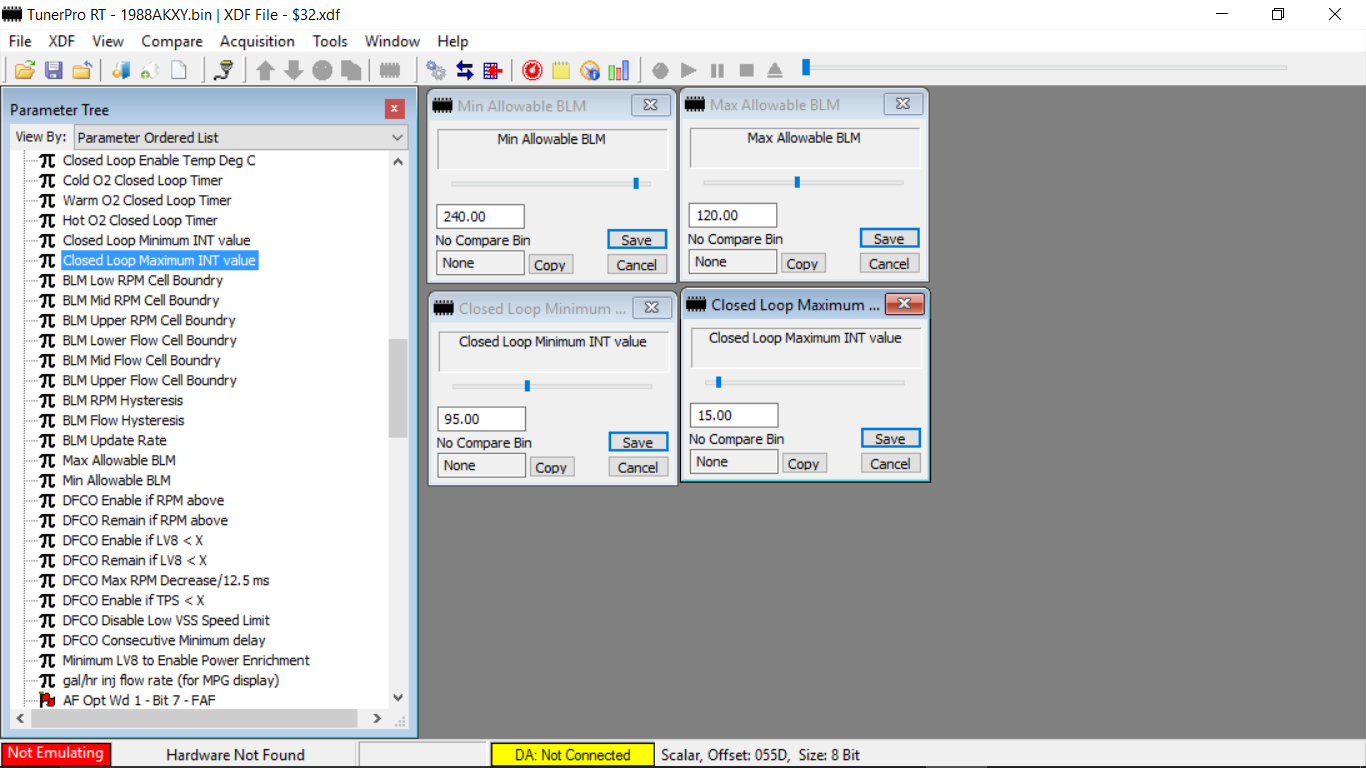

your running real lean blm looks almost locked at 150 and knock counts are high....
Brian, did you look at the bin he was using? Never bothered to look at AKXY myself in all these years, only ARAP, but does this even seem normal to you?
- Rob

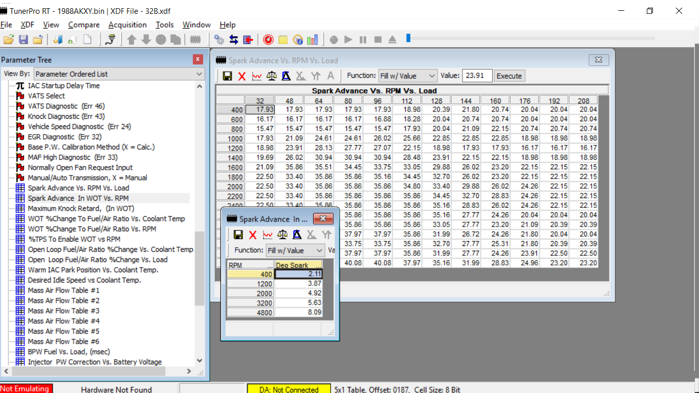

That doesn't make sense, are you looking at it in a $32B xdf ?
Old Apr 20, 2020 | 04:47 PM
Street Lethal's Avatar
iTrader: (16)
Joined: Jul 2003
Posts: 10,539
Likes: 206
From: NYC / Jersey
Car: 1990 Trans Am GTA
Engine: Turbo 305 w/MS2
Yeah that was it, was too quick when selecting the XDF in Tuner Pro. Was saying to myself...; I knew people avoided AKXY like the plague, and when I happened to see that, I was like, hmm I now see why lol. But yeah, just uploaded the correct XDF and it looks good...

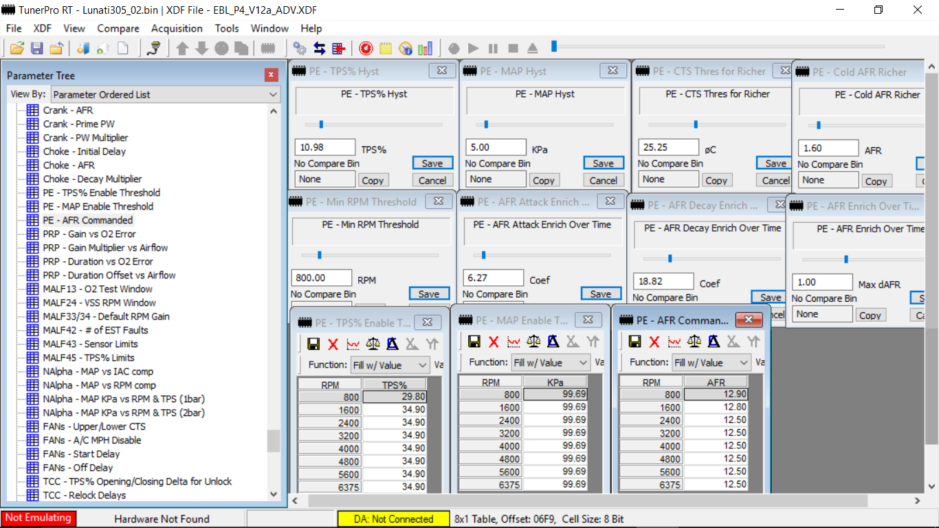

I think you’re asking about the pe adder or subtraction In wot
Values are a little bit different from what I was looking at, unless you nabbed a screen shot of a different bin altogether, screenshot below. If PE based then makes more sense, it just doesn't specify Power Enrichment in the XDF like I have gotten used to over the years...
- Rob
Not to derail the thread, but this is what I am referring to in regards to PE...;
- Rob

Posted in my mega thread by accident last night, couldn't figure out why I couldn't see my post this morning, haha. Still acts like one is light on the throttle. This tune is much better, much more responsive. I do like the $6E definitions, dash, all the data one can see compared to the AXKY. Here's the log - different run than last time (different area) but still had a few places I shifted into 5th and it lagged from 65 to 50mph.
I shifted from a lagging 5th into 4th gear again to gain speed around 1:12 up a slight uphill (not the grade from earlier AXKY log).
Got off freeway and started up a hill the other way around 2:52, and shifted from 5th back into 4th gear around 3:56 to not get run over by a semi.

Do you have headers ?
No closed loop operation and code 13 for o2 sensor.
the o2 really didn't move off.450
looks like either the 02 is dead or there is a break in the wire going to d7 of the ecm.
