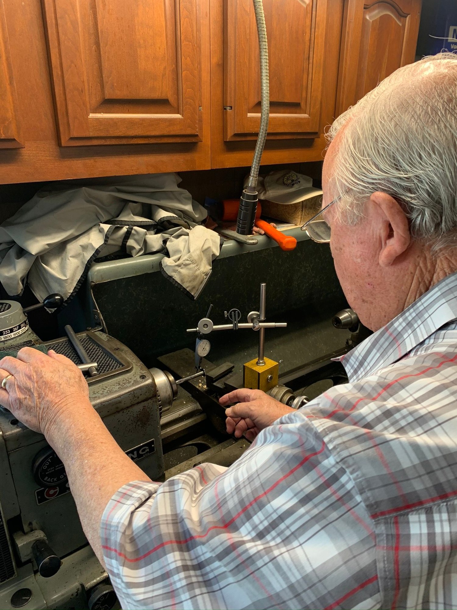

I disassembled the TB again- I literally can remove it, and completely disassemble it in five minutes. Reassembly and installation is not much longer. What a talent I have acquired! Lol.
So I recalled the shaft being a small amount out of straight but there was very little drag on the assembly. Very light- but not that loose, "clanky" zero. So I thought what the heck. Took it apart and ran over to my Dad's house. He loves this kinda stuff. He has a small machine shop in his garage and is an old school machinist hobbyist.
Here he is working on it.
He got it to within half a thousandth and it became that proper, loose "clanky" when opening and closing (bushings and side clearances were all tight though).
I then reset my return spring to stock index setting, stop screw to stock and simply installed the plates. I had measured them and the holes, bores, and shaft bore are all on center (no bias). Threw it on and bam- 100% perfectly behaved TPI engine. Holy moly.

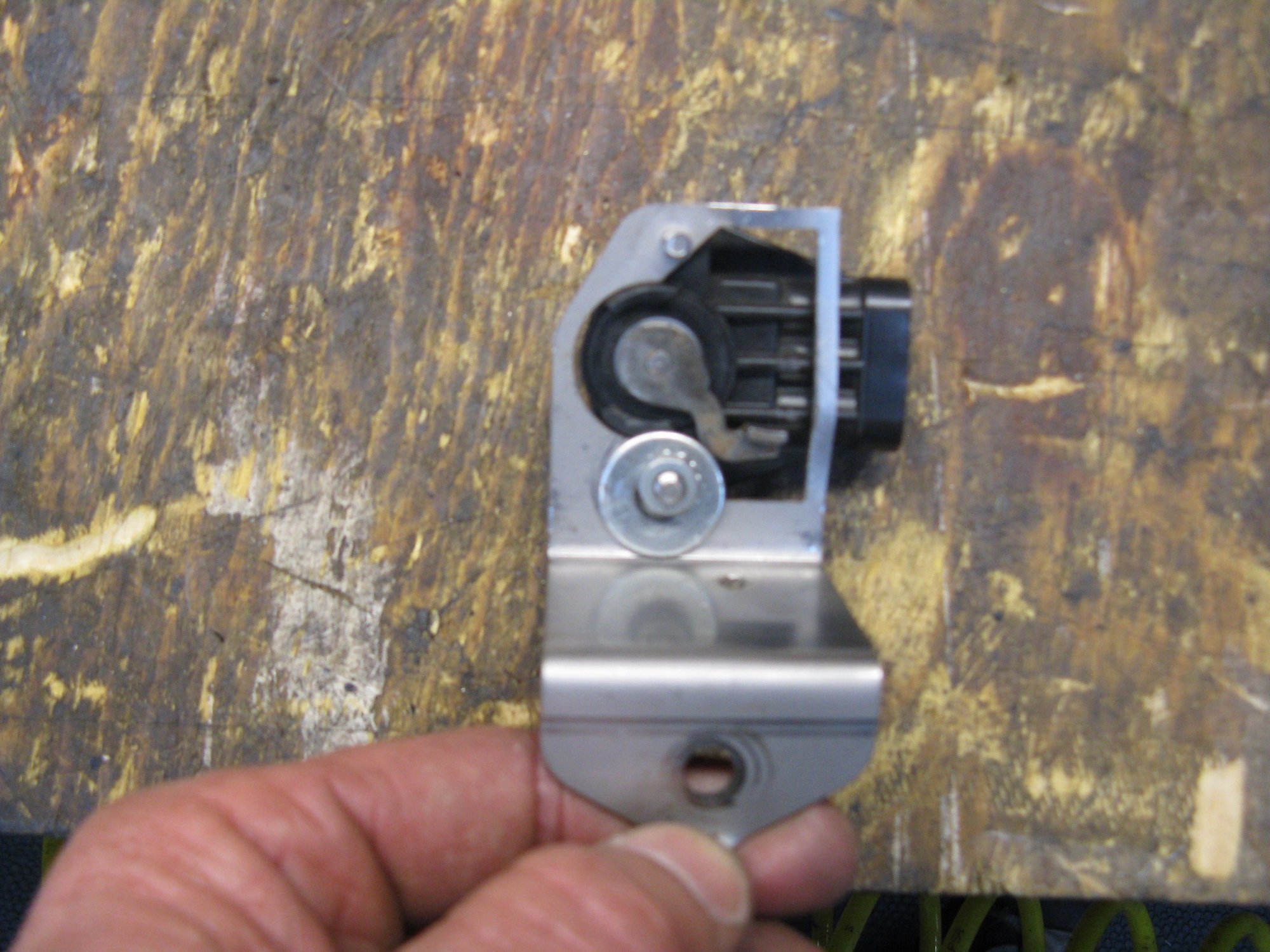

I fixed a similar problem on a FIRST® intake throttle body. A slight play in the throttle plate shaft was creating the problem. When releasing the gas pedal slowly to idle, the TPS lever would be raised a few thousands. That was increasing the TPS voltage, thus increasing RPM at idle. The ECM thought I was feathering the gas pedal, thus opening up the IAC a bit. The problem would not happened if the gas pedal was released quickly or a gas pedal jerk was given. I found out by datalogging and observing the TPS data. Solution was to custom make a TPS stopper and adjust it so the TPS would rest a few thousands higher to compensate for the shaft play.
