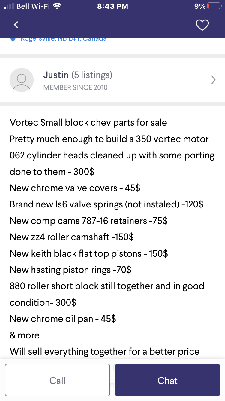

Found a good price in a ZZ4 cam and some Vortec heads.
I already have my SD Vortec Intake.
Will this cam be usable for my 1987 350 TPI system?
What I have to also consider is I have a 1st TPI System but it will not be going on the engine this year. So I’d like I cam that I can run now and use that same cam when I install the 1st system.
What else could I use from this list of parts ?
