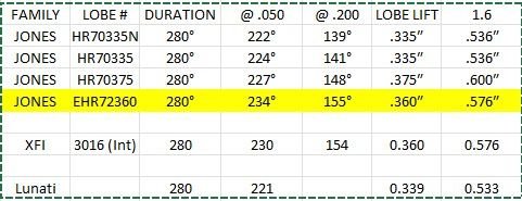

...to me that starts around 230 deg in a 350..
I'm right in that camp for the 357 but I'm working more with seat to seat timing (280 in this case).
