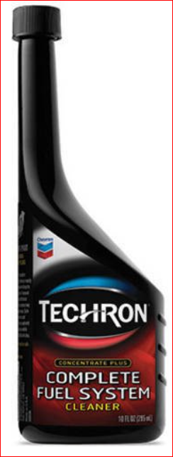

"not being driven much doesn't help". Yes, with ethanol fuel, this can cause issues. Seafoam does a good job, but Chevron Techron specifically targets injectors. Search for reviews/results.

Not a Chevron even remotely close to me lol, I always run 93 or higher in it, but I'm gonna dump another can of Seafoam in it next fill up.

Meant this available at any auto parts store < $5:
Oh I see, I'll give it a shot next time, Thanks
