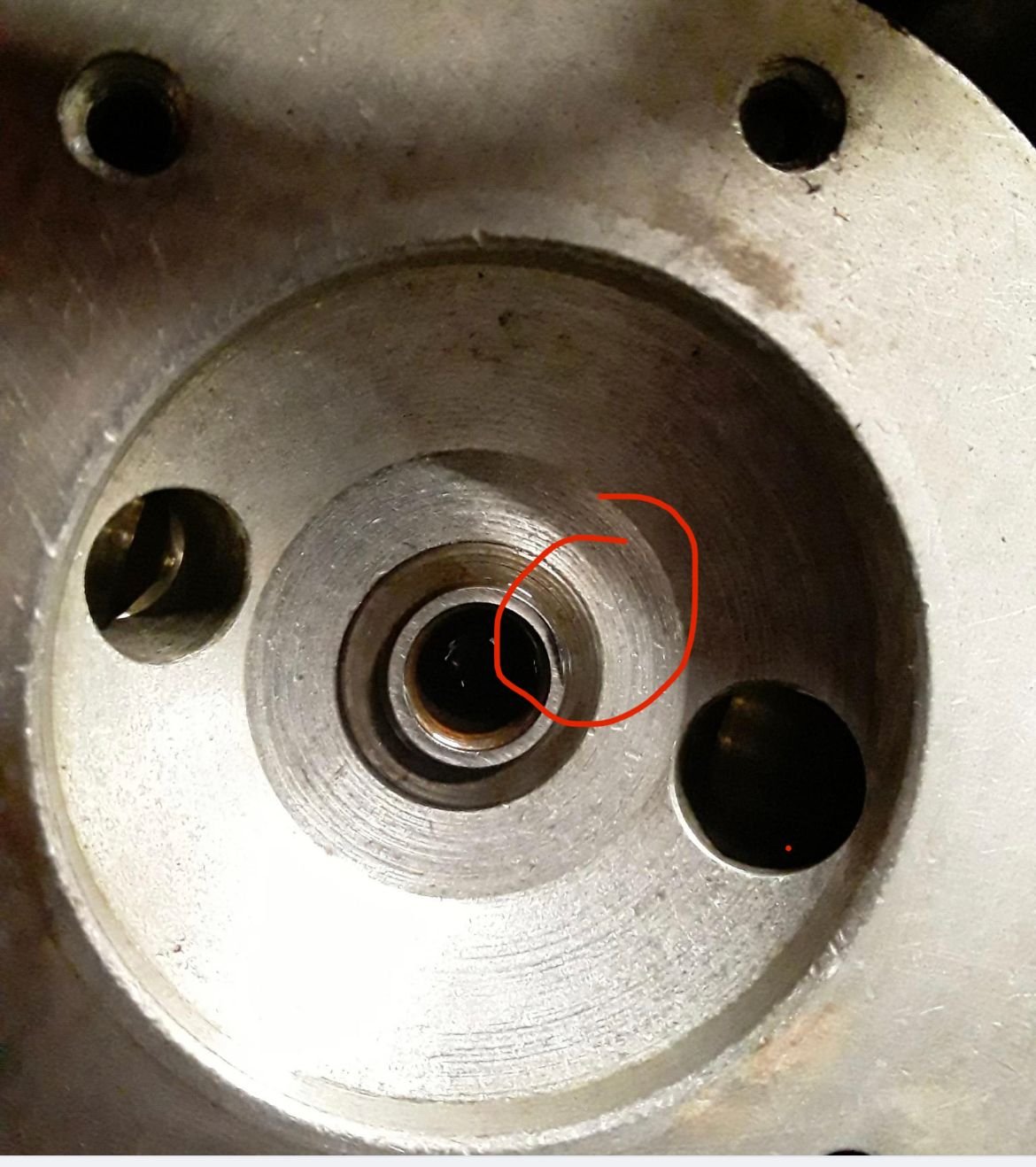

Take a close look when apart at sealing surface on regulator body seat.
I’ve seen what looks like nick that will allow the regulator diaphragm metal seal off the return line port.

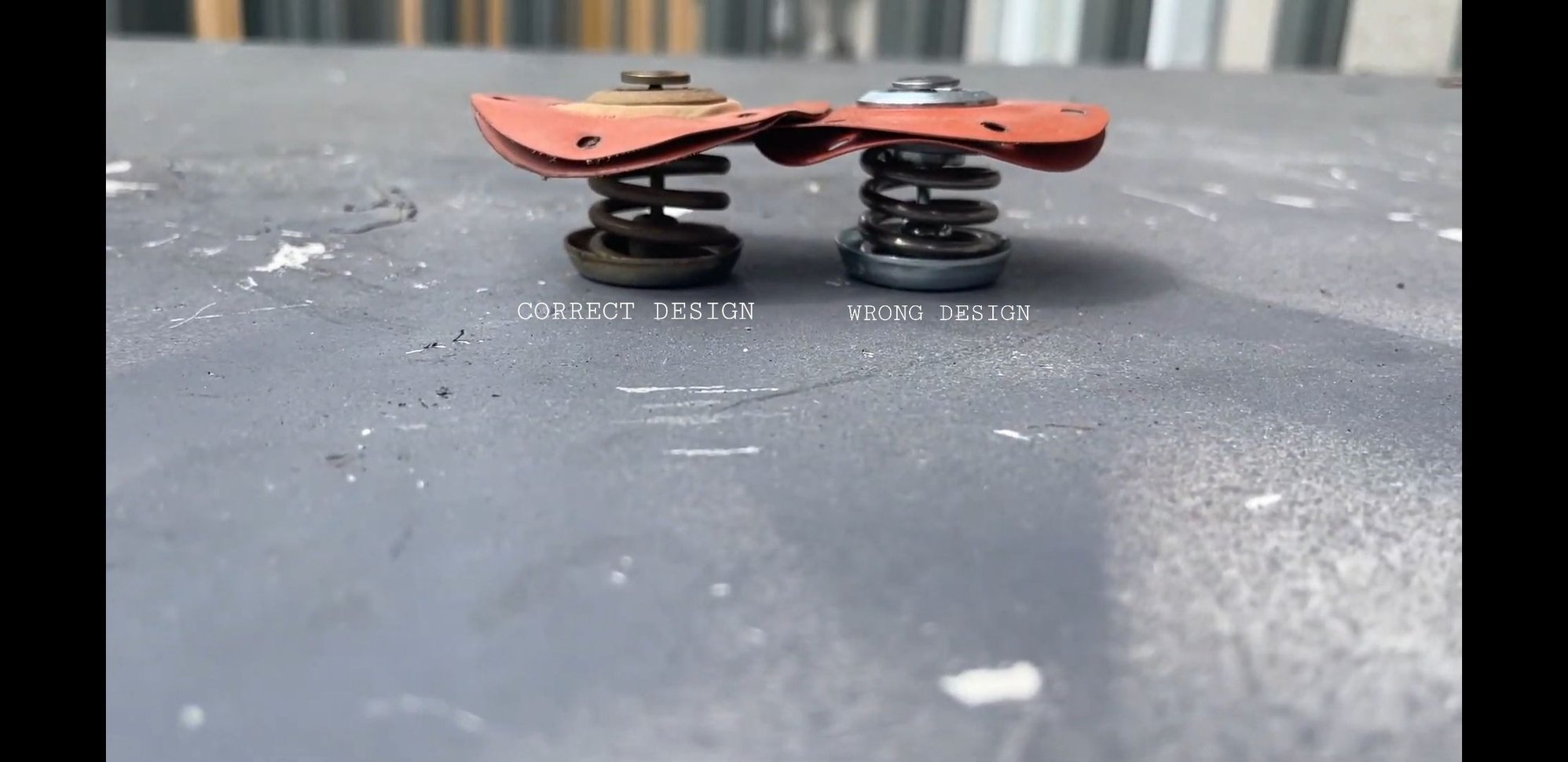

I TOO REPLACED THE OLD FUEL DIAPHRAGM RECENTLY AND HAD SAME ISSUES. LOOK AT THESE IMAGES, MAKE SURE YOU GET THE CORRECT DESIGN DIAPHRAGM.
ACDelco 214-2156
