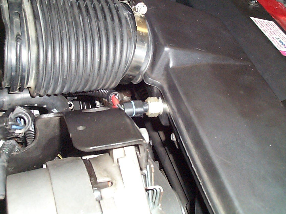

CTS and MAT (same function as IAT) are the primary inputs, The MAT in the stock location is on the underside of the plenum. That's not very convenient. Moreover, the sensor can be artificially heated by the plenum, so restart sensor readings can be way off.
My '86 is similar, and I moved the sensor location by abandoning the original in place and adding a second IAT and extension harness to mount it in the intake air duct.
It was an easily accessible connection to the wire harness.
