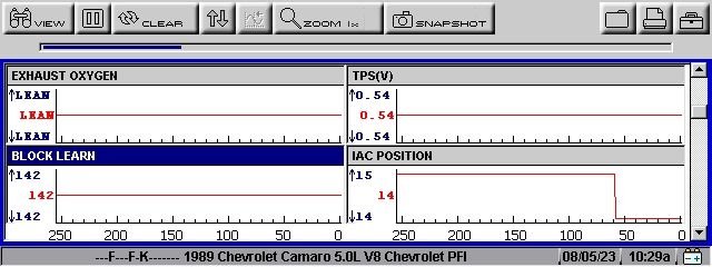

Here is the data stream when at full temperature. Anything on these images look suspect?
I can make better ones, or if there are some that would be helpful to group together over shorter times just let me know.
thanks for any ideas
Also, the cooling fan had kicked in while saving the data, thats why the temperature is shown as dropping.

Can you datalog in tunerpro rt ?
Is the cts dropping in that image ?

Opps sorry just saw the temp drop reason opps

One more.
I realize this is just what the ECU thinks is happening. If there is something I should pull right from a sensor let me know.
I have an older snap on solus pro that I am currently using. I have never used Tunerpro rt. I'm kinda old school
I do have a snap on verus edge that can do so much more & It has a labscope if I need to tap some reference wires directly.
But unfortunately I don't have an OBD1 cable for the scanner, otherwise I could post some much better logs
