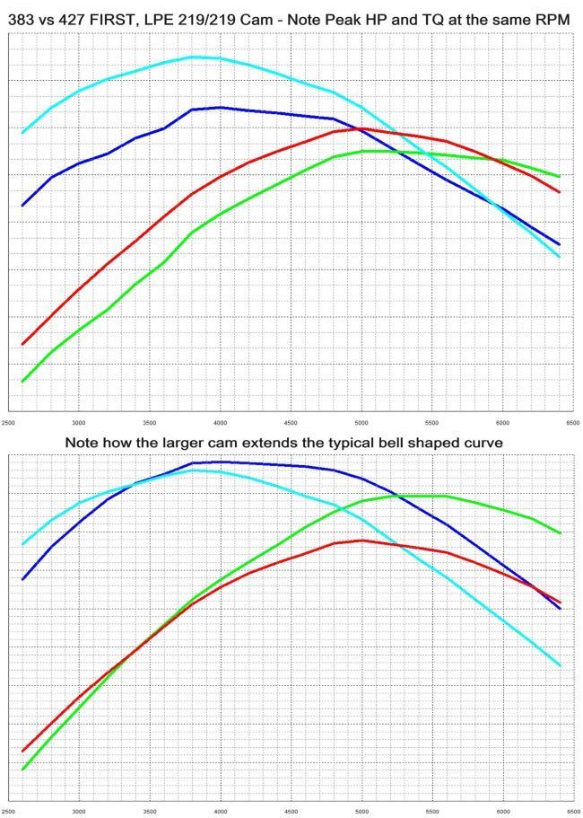

This may be hard for some to believe, but if you want to get the most power out of a FIRST, you need to go big on the cubes, large on the heads and head-flow, and relatively big on the cam (compared to typical TPI thinking). The runner length does limit the RPM capability, but the cross-sectional area of the intake tract is (or can be made) big enough to allow the cam you pick for the heads to make “short-runner” peak torque. Meaning, you can extend the upper RPM of the bell shaped curve you see with a “typical” TPI.
Most people stick to the typical TPI “recipe” and they only get a marginal advantage from the FIRST.
For example the top graph is a set of “bigger than typical” 220AFR heads on a 383 and 427 (same compression) with the FIRST (stock runner length but opened up to 1.875” diameter) and a “typical” TPI cam, the 219/219 LPE hydraulic roller. Note they peak at the same RPM, which in most cases the typical TPI will peak at a lower RPM on a larger engine.
The bottom graph is the same 427 as above comparing the LPE 219/219 cam to a moderately sized 240-ish solid roller cam. Note that the bell shaped curve with the big heads, while similar to a “typical” TPI curve, is extended well past the “typical” TPI RPM range.
If that didn’t do it for you and you wanted more RPM, then you could always weld up the creases and Siamese them.

I "think" the FIRST is too big (cross section) for a 350 but am looking forward to trying one. IOW, it makes sense to me that it is better exploited on a large cube motor As BasSS was pointing out. One question that I have, that I have no experience with....and never will, is: Would a "medium" (CS) TPI like the TPIS Big Mouth base/runners, on a 350 with the same cam , OR with a "proportionally" sized cam (for the 350 vs 427) make power peak at the same RPM as it does on the 427 with the FIRST? IOW, is the 427, simply a "TPI" engine where the engine and the runners are proportionally larger, and thus is does the "same things at the same RPM"....only MORE so? Or, put another way, if more cam makes the big motor/big runner combo rev higher, will a proportially bigger cam on a small motor with medium runners mirror that tq/pwr curve (make peaks at the same RPM's), only lesser of it? Does that question make sense? I'm thinking BadSS can answer this from experience? IDK....
Generally speaking, when you go bigger on the CSA than you “need”, it won’t be able to pick up enough top end to make up for the midrange it will lose.
There was an old test on a stock engine where they tested the stock TPI against AZ Speed’s long/large tube runners with an aftermarket base and the FIRST. It showed that the smaller CSA of the AZ combo worked a little better than the FIRST on a stock engine. However, the FIRST did improve power at all points compared to the stock TPI. To me, that pretty much proved that the stock TPI is too small and restrictive even for a stock engine. The FIRST made better peak HP and didn’t drop off as quickly, but the average power was about the same for the aftermarket large tube combo and the FIRST. So, even though the FIRST may be “too big” for a stock 350, it’s still better than the stock TPI and has a lot more room to grow than the AZ combo.
I'm not sure I fully understand what you're asking, but maybe this helps? On a 355 capable of making 420-ish FWHP with a short runner intake, the box stock FIRST was 0.4-seconds and 2-mph faster in the quarter mile than a heavily ported (but not welded) stock TPI base and SLP runners siamesed to a little before the halfway point. It had a 218/228-110 flat-tappet hydraulic and heads flowing in the 240 cfm range at cam lift. I shifted the TPI/SLP at 5500/5300 and the FIRST at 5800/5600, although the FIRST ran the same time shifting at 6000/5800. So,,, it was definitely holding the power out a lot longer than the TPI/SLP combo even though the TPI/SLP had a shorter effective runner length. The FIRST did roll off a little torque around and below the stall speed of the converter (3200 rpm) which was actually a good thing – hooking up on the street tires was practically impossible with the SLP/TPI intake, but semi-manageable with the FIRST. The trade-off was well worth it as it shifted the peaks up in the RPM scale.
So, it’s not too big for a moderately powered 350 and the ability to increase the CSA of the intake tract to keep up with the airflow of bigger heads is why the FIRST can work so well on larger engines.
