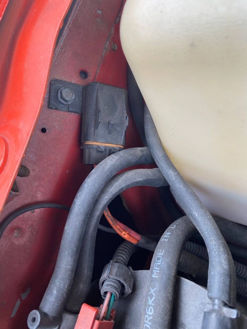

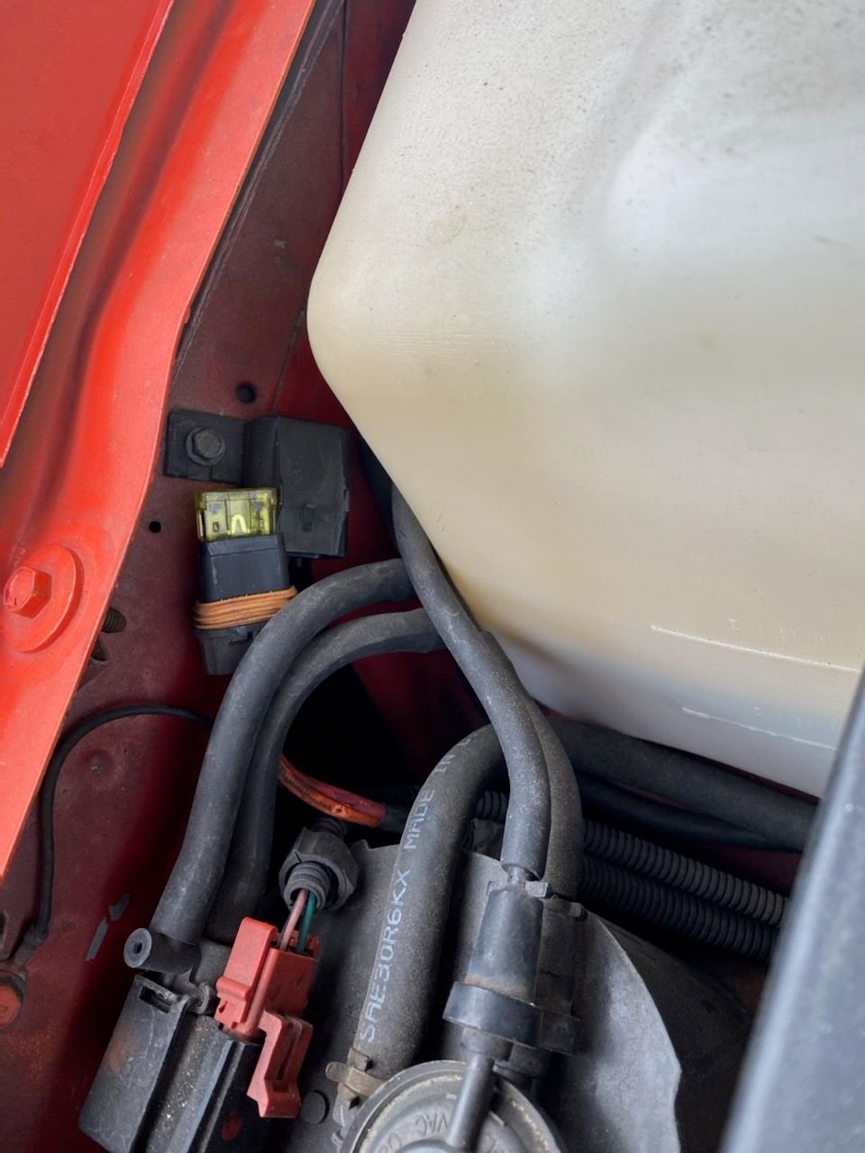

Have you checked this fuse?

I just checked the fuze and it was blown so I replaced it but I still don’t hear my pump prime

I’m assuming that fuze is the one on the passenger side but I see your evap can but on mine the evap is on the drivers side while the battery is on the passenger side. Is my car just weird and swapped?
