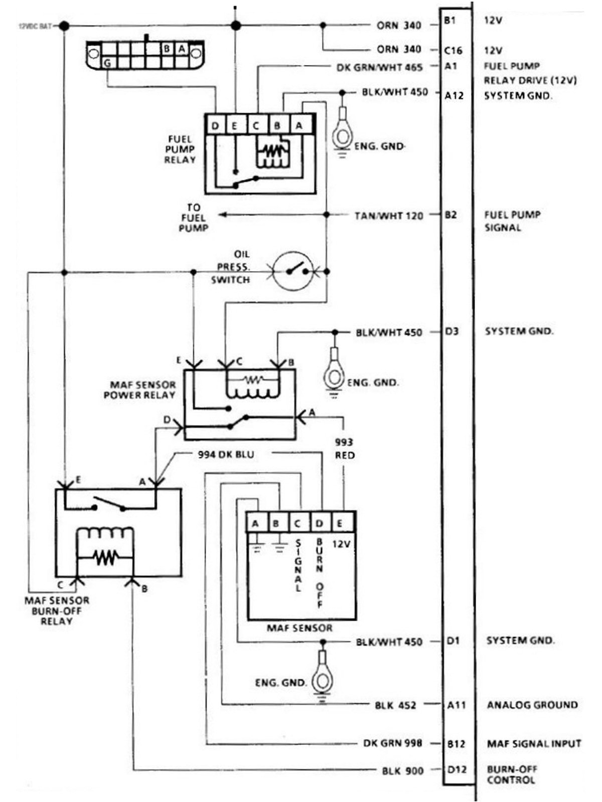

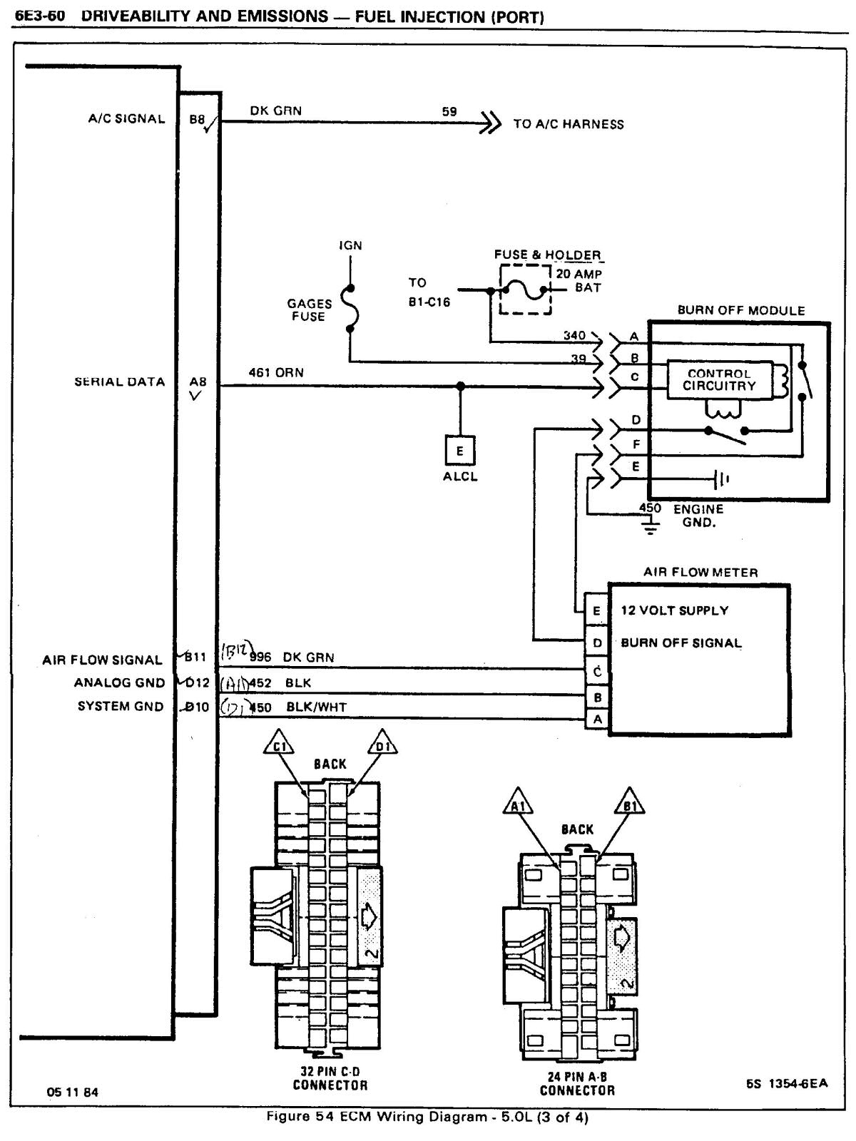

It would be good to verify that the MAF is getting correct voltage while running, and is performing a burn-off cycle when shut down. The 1985 TPI is a one-year exclusive:
1986 and later year TPIs with MAF were handled quite differently:
