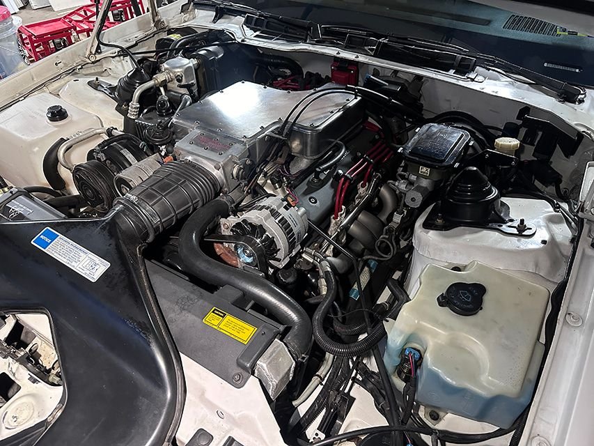

Ok where do I start.... well I know where to start, so where do I go from here
92 Z, 383 Super Ram running Dynamic EFI EBl P4
Vehicle is not starting. It is rarely driven. Over the summer I drove it to work one day and it was great, Leaving work it wouldn't start at all. I ended up coming back with my trailer the next day and it started just fine to get on the trailer. When it runs it has no problems running, does not stall or anything like that. Fast forward to this weekend and I got done upgrading my fuel pump, drove it around yesterday with no problems. I wanted to drive it work today and it wouldn't start this morning. Still not starting tonight.
Does not even try to kick over, just cranks and cranks and cranks. Oldest part in any of the ignition system is 3 years old and less than 2k miles. Honestly that description goes for every sensor. Fuel pump is brand new Aeromotive Stealth pump and priming just fine.
Plugging my laptop into the Dynamic EFI computer the readings I get with just ignition on seem normal. Not sure where to look.
