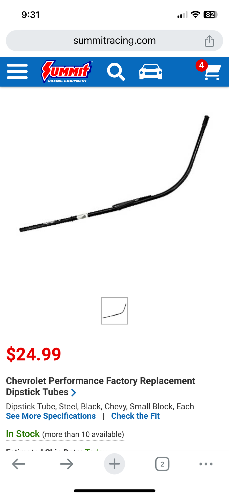

I am also in need of one. Others in group say one for the gm ZZ4 (I may be wrong on engine designation) engine will work but looks like it will need the dipstick that matches it (different top end opening and maybe longer or shorter than what you are replacing). See pic attached and Summit part # is :
Chevrolet Performance Factory Replacement Dipstick Tubes 12551154
