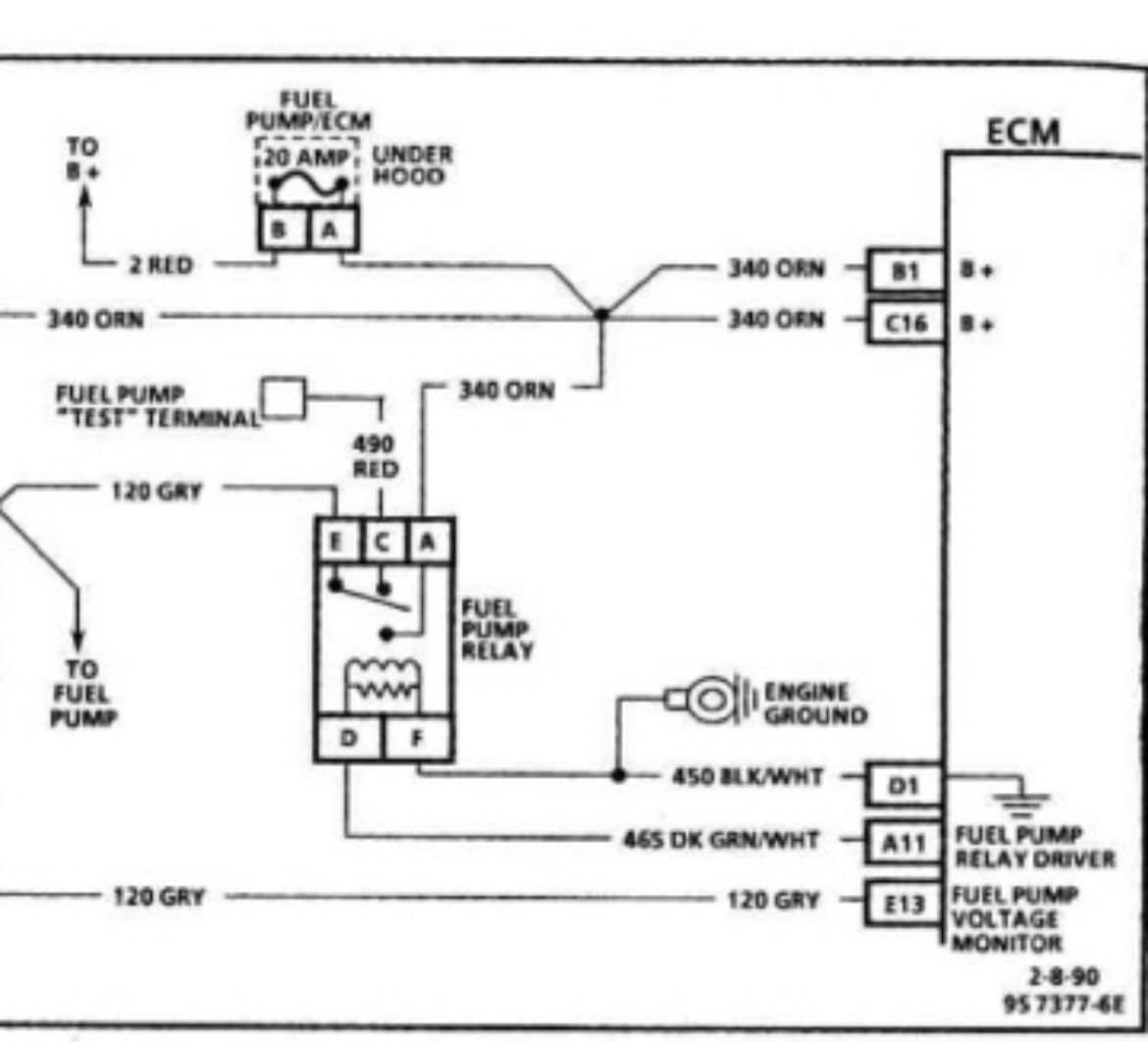

Ops is backup for fp relay. It closes at 4psi. What is the voltage at ops and ecm content powers ?

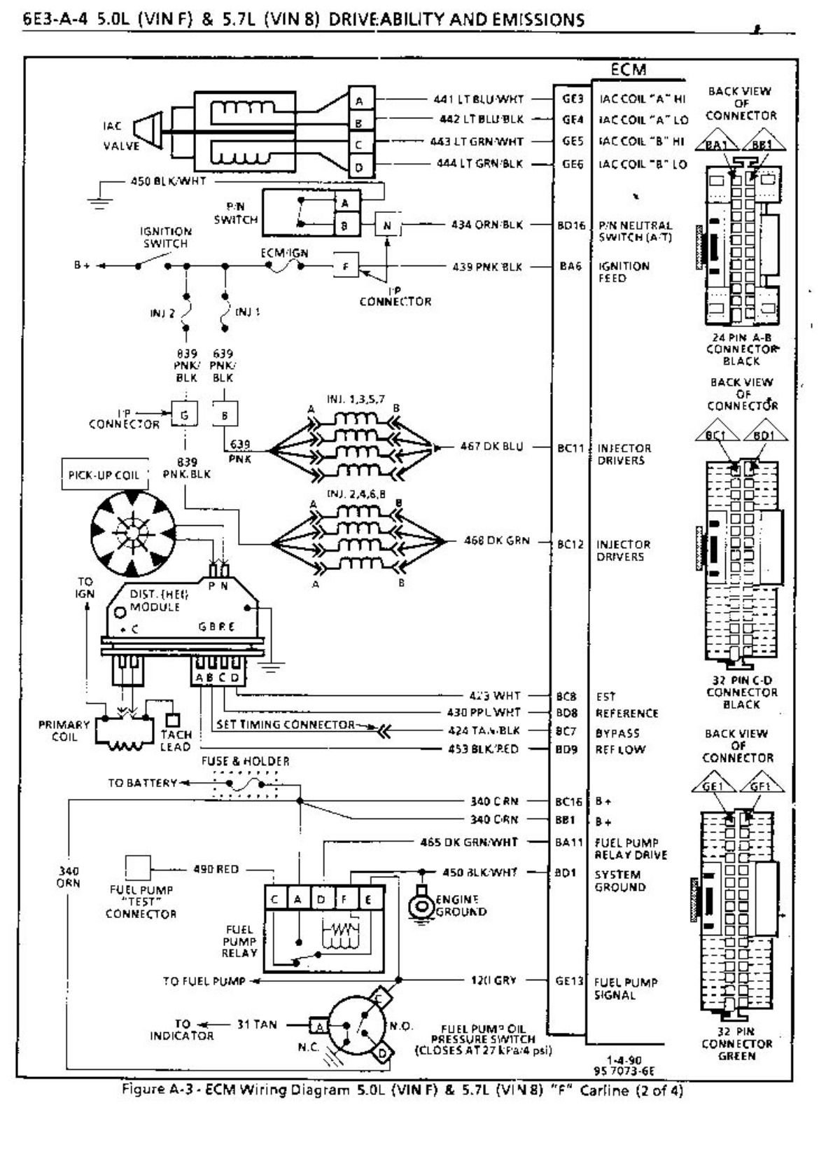

Checked the wiring diagram, noticed that the Orange constant from the battery split somewhere in the loom. One goes to the OPS, and two others go into the computer.
Got a little bare wire on both Orange Constants that lives in the harness past the OPS going into the computer. Sure enough, no voltage.
So, my best guess is that ONLY when the OPS sees pressure, it allows voltage into the computer. Not sure why exactly unless the switch itself has a ground fault when opened.. maybe..

It’s wired like this, as I said before the ops has nothing to do with ecm operation. It’s backup for if the fp relay fails. See schematic.

This is how it is "Kind of". Instead of the fuse&holder, there's a two wire plug coming from the battery. The red from the plug goes to the fuse, turns into Orange from the fuse, and spits off into the constant hots for the relays on the firewall, and the orange from the plug disappears into the harness behind the engine bay where at some point splits into the three hots. One for OPS, Two for computer.
I understand that what you're saying SHOULD be the case. But for some wacky reason, it isn't. Once I added new constants into the harness past the three way split, everything worked as it should.
I would chalk that up to a bad split if it wasn't for the fact that once there's oil pressure, the computer gets power.

Nice job diagnosing the problem. I like that you didn't let wiring diagrams dictate your diagnosis and kept a hands-on approach. This isn't the first time I've seen a problem that "shouldn't" exist because of the way the car is wired.
