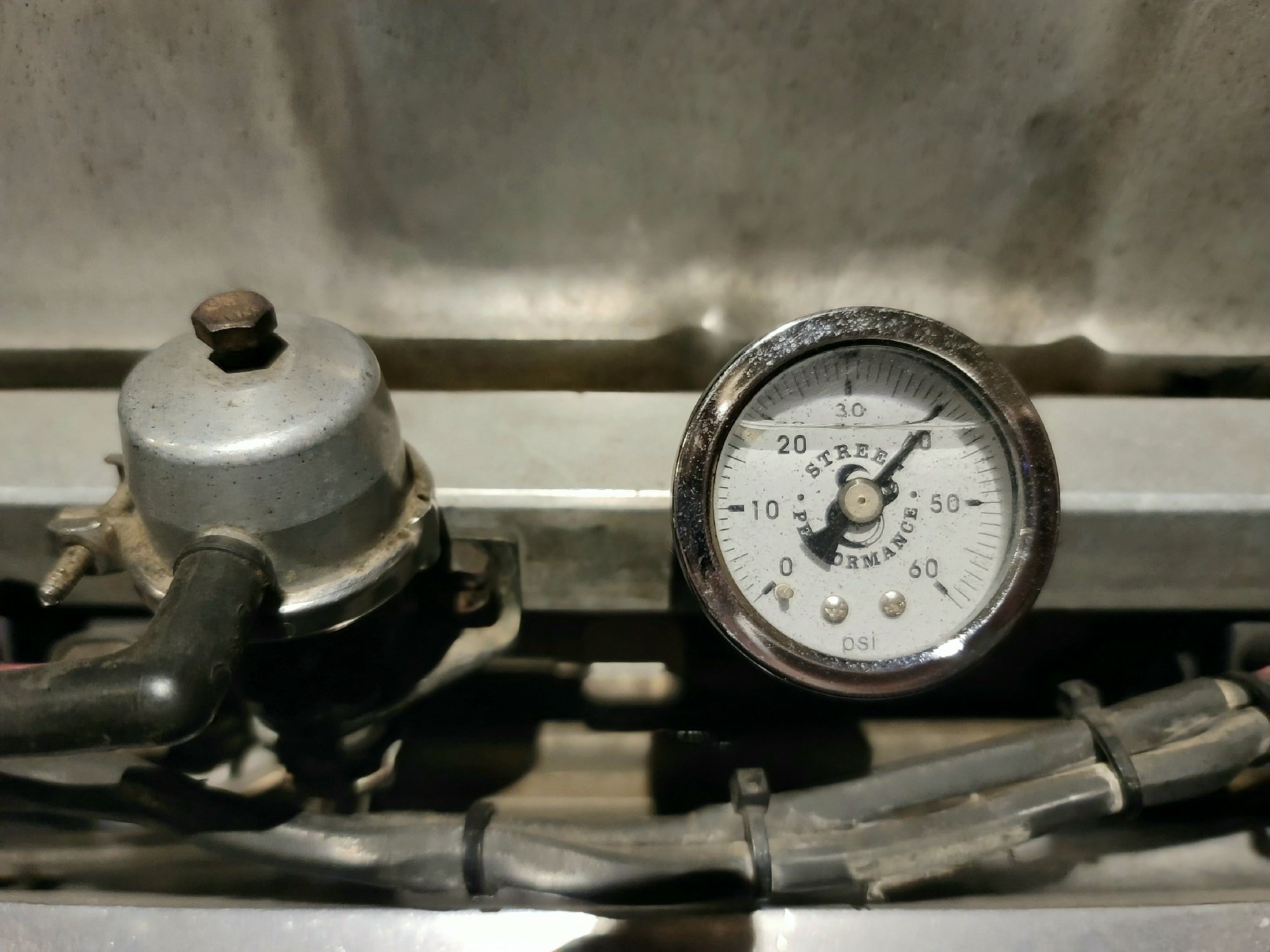

Verify timing with esc disconnected is at 6 btdc. Check fuel pressure via mechanical gauge on schrader valve, should be 38-43.5psi. Verify all sensor data is accurate via live data stream comparison with reference values in factory service manual. Smoke test intake manifold.

Someone might bring up that not all ICMs are created equal...but let's concentrate on the cold right bank. I'm not for certain that a busted fuel pressure regulator diaphragm could introduce so much unmetered fuel that it would cause the entire right bank to not fire. Being that it dumps near the 6-8 cylinder runner those would be affected more than 2-4 cylinder. With that said, check the vacuum line for any fuel before you dive into checking fuel pressure.

Fuel pressure verified, I have a gage on the fuel rail with an adjustable regulator. No fuel in vacuum line either.

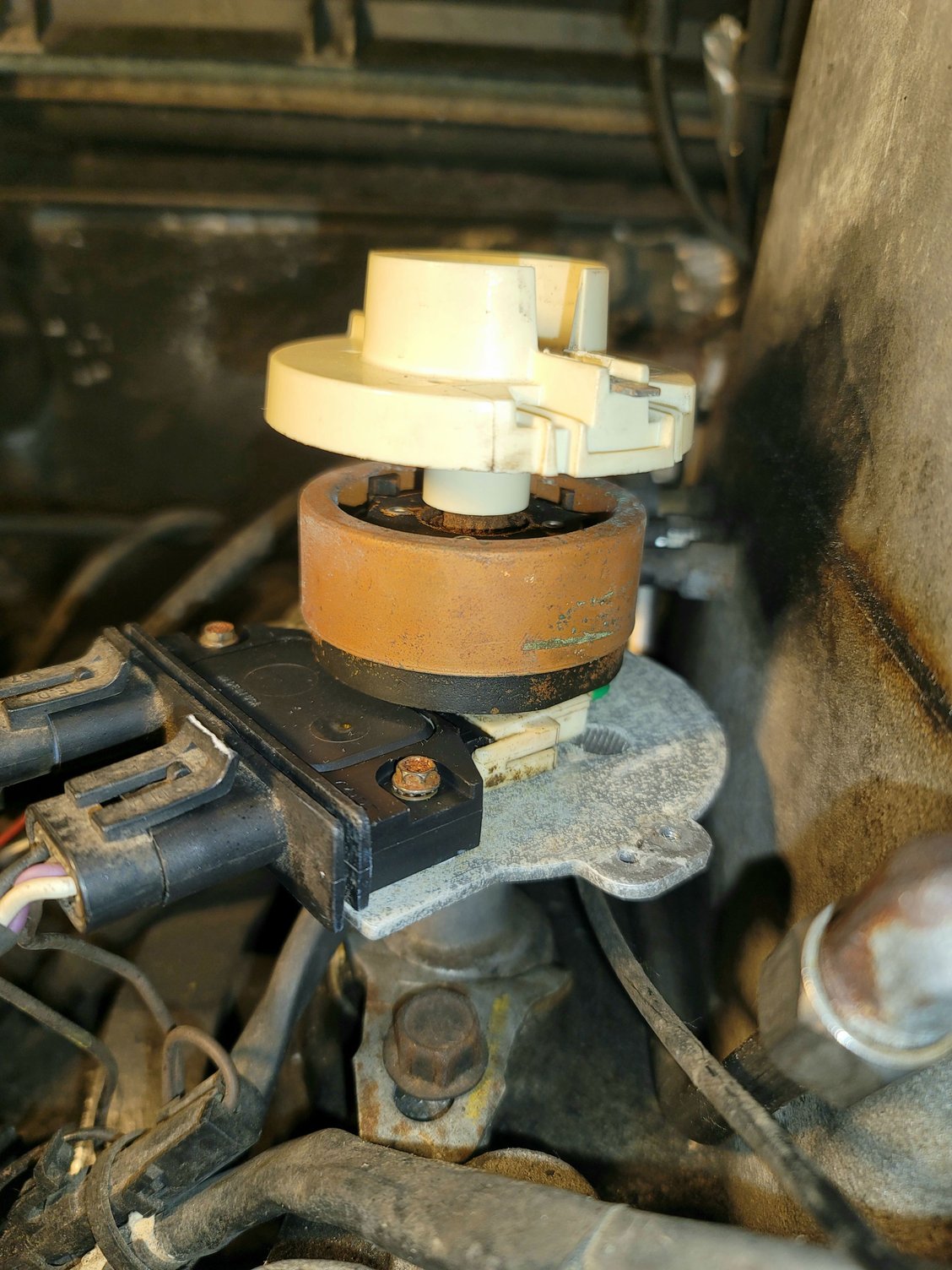

did you check the pickup coil? The reluctor wheel in good shape? Not rusty, broken or cracked around the rivits?
This can definitely make the car run like crap.
Looks OK I think.

Pickup coil Needs ohm tested, the ign module doesn't look to be a GM part. May want to look in to testing that too. Id be putting in a GM/delphi unit if it was me. Or buy a nos GM distributor, big bux but 100% worth it.

This is what you want to be looking at when doing a visual inspection.
GM Small Cap HEI Distributor Magnet Cracks.

I can, however, ohm out the pickup coil without too much trouble. What should it test at?
