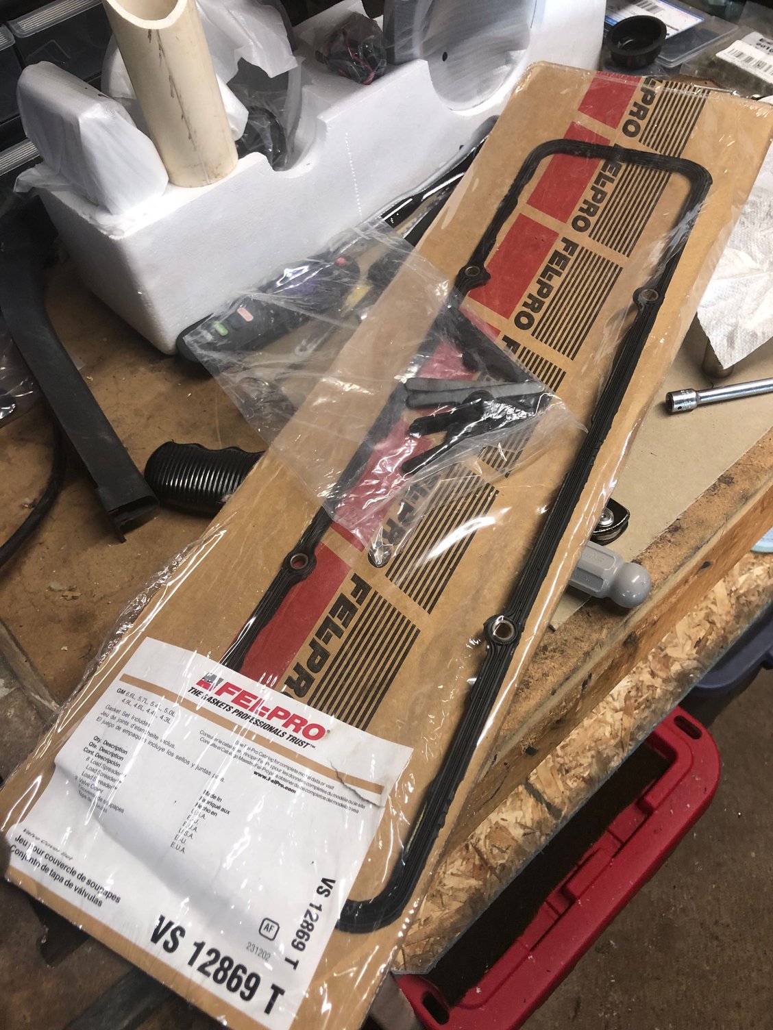

I just installed these felpro rubber ones on my 84 TA and am happy with them.
Was quite the project removing emissions lines to get the covers off!
