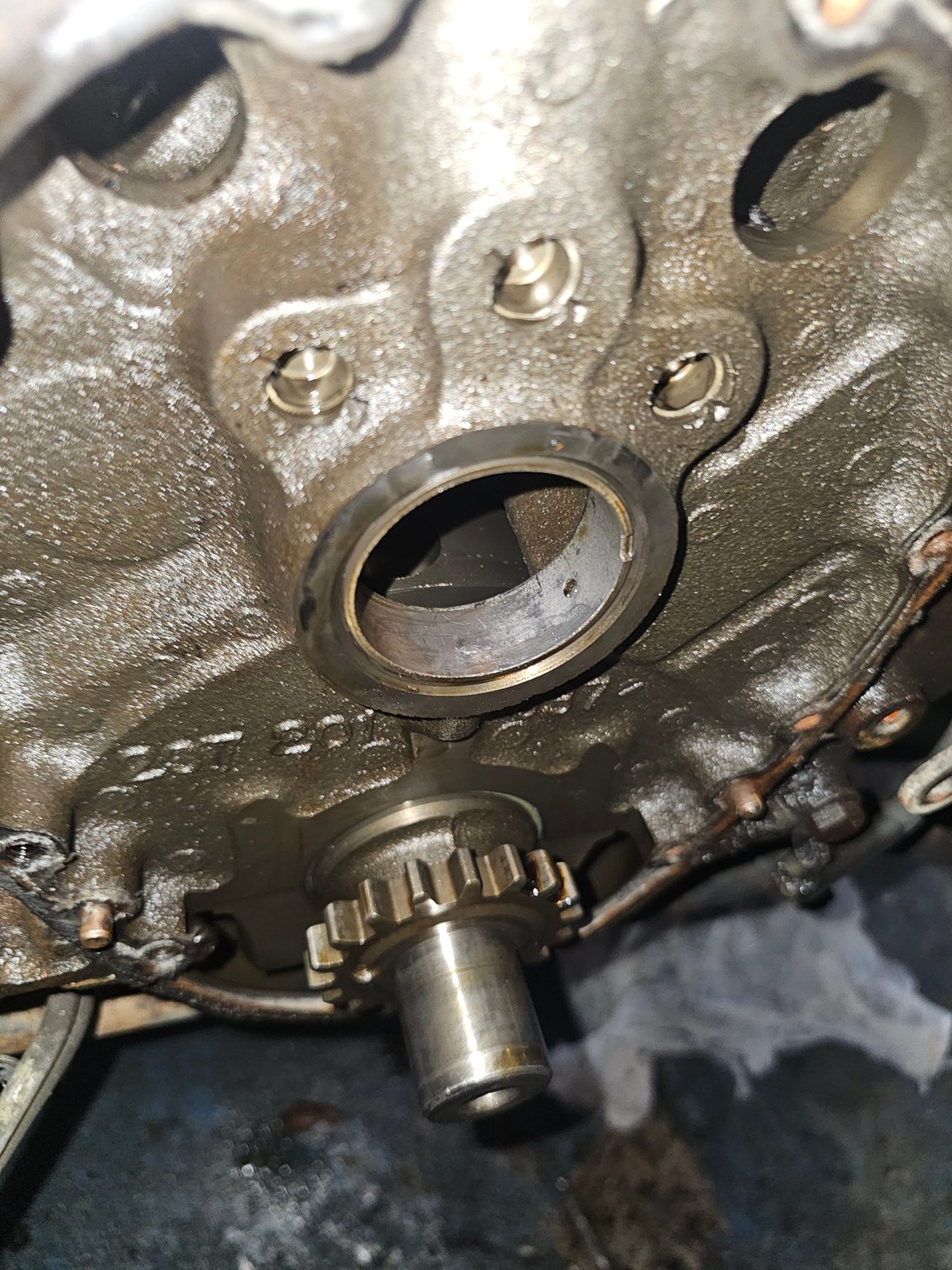

Hey guys, been a while. I'm finally getting around to my overhaul that I was planning out several months ago. To make a long story short, the camshaft bearings were wiped out, which has really extended the timeline for the entire project.

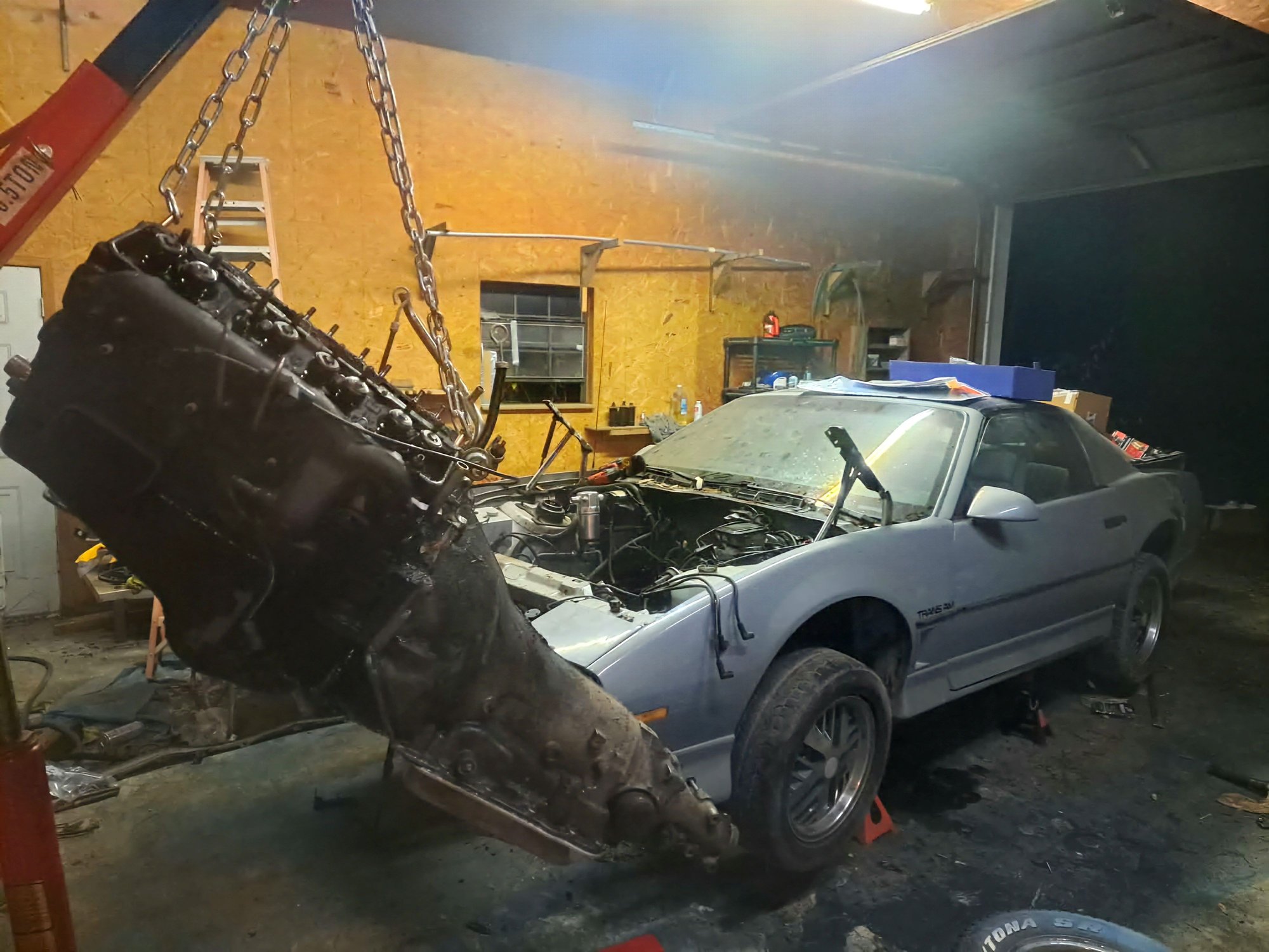

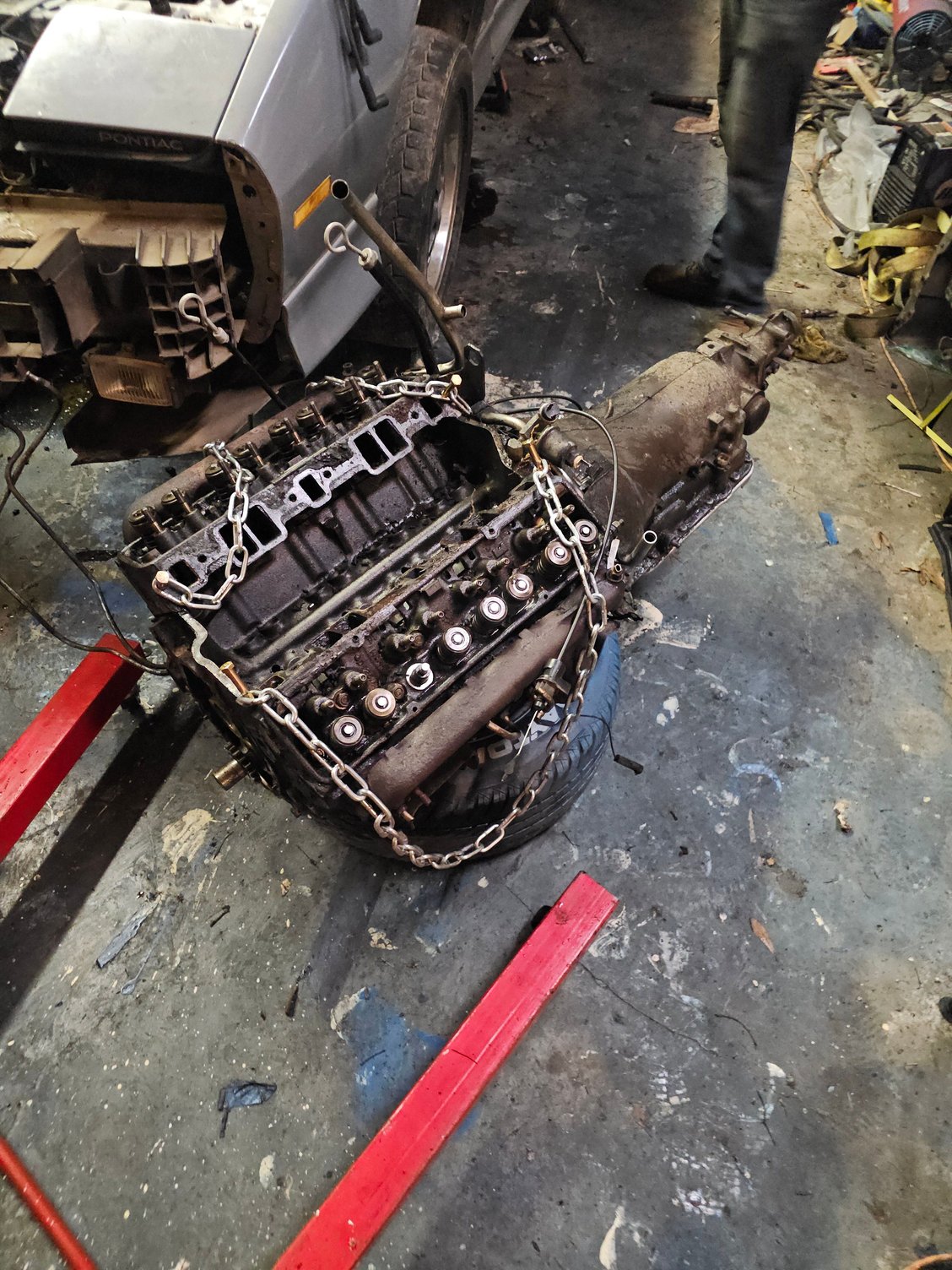

Pulled the full powerplant out through the front over a weekend with my buddies help:

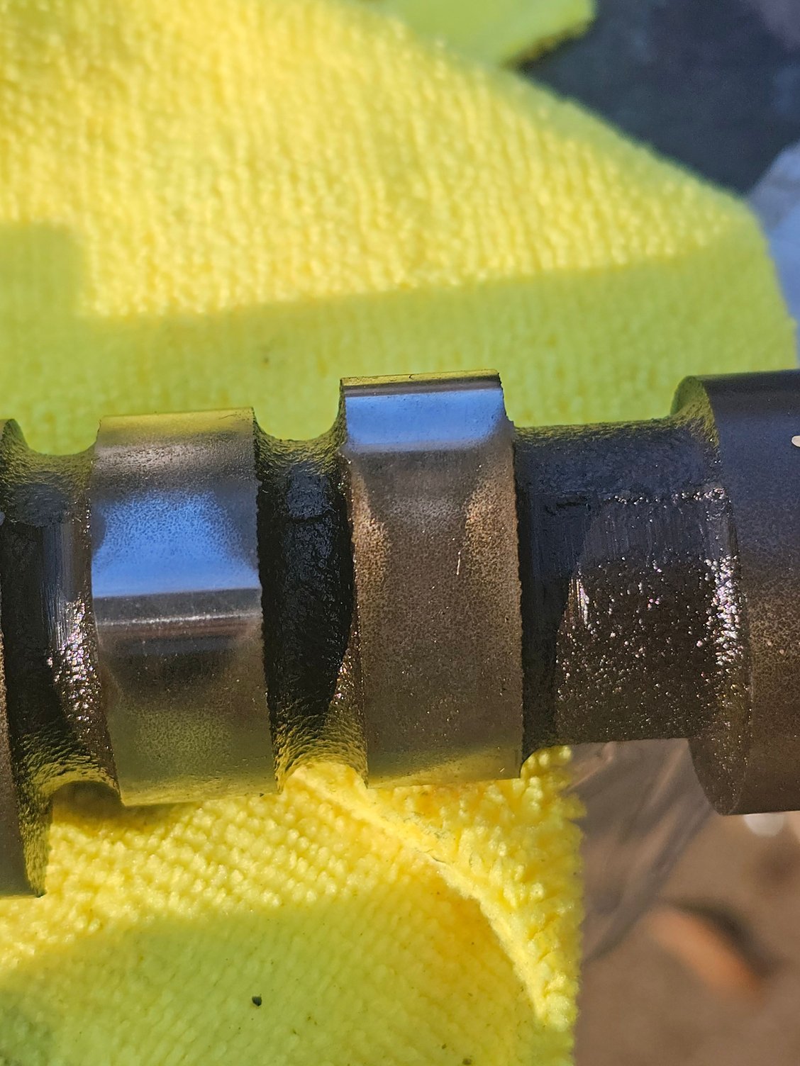

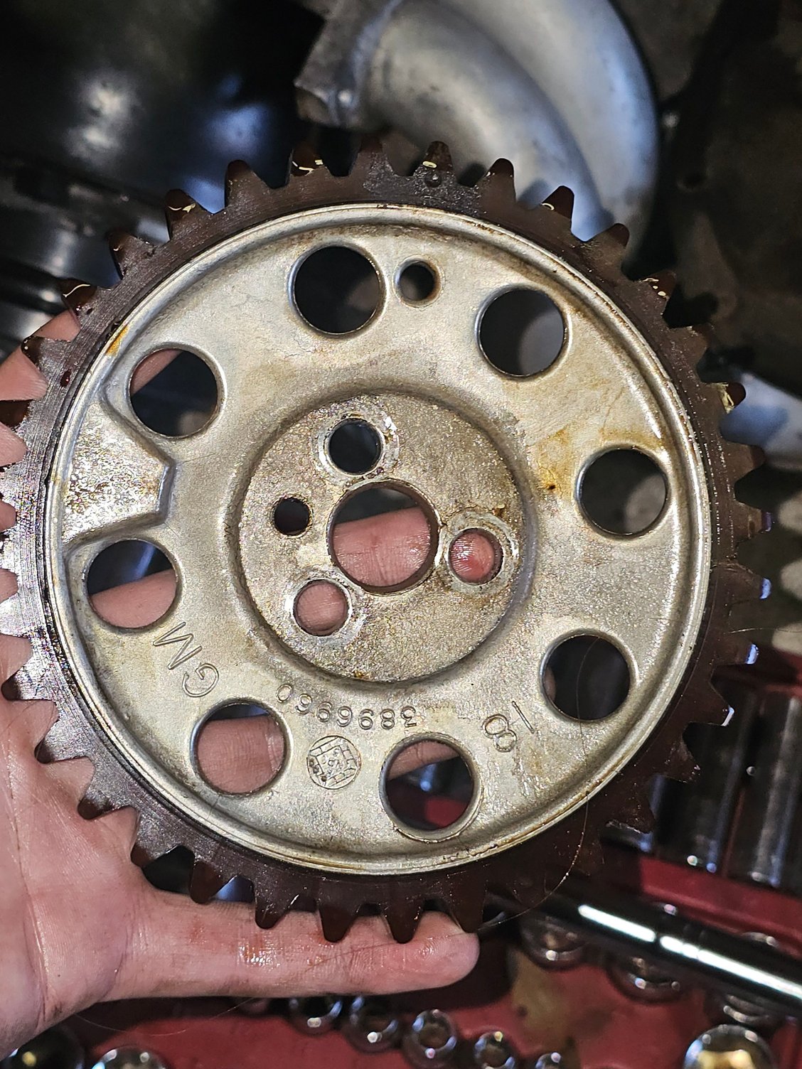

Pulled the timing set and camshaft. Bearings are wiped, but on the bright side, it has its original nylon timing gear, so I know the car is probably sub-100k miles!

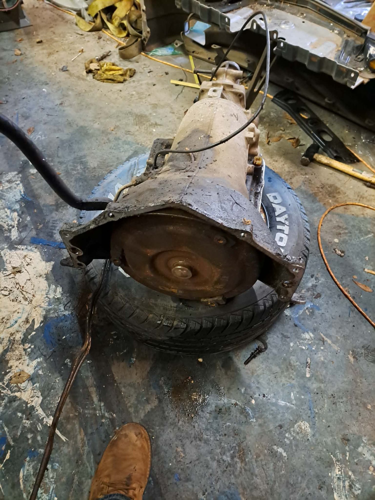

Transmission is done:

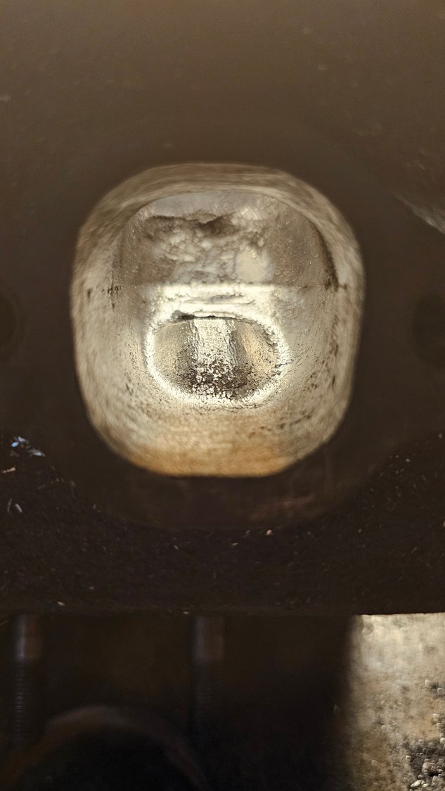

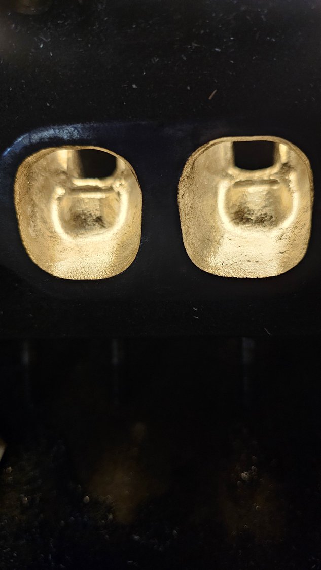

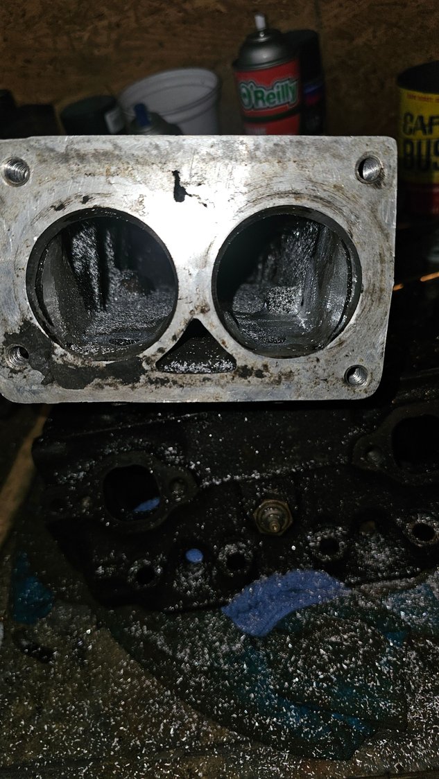

I've ported the heads, LIM, and plenum.

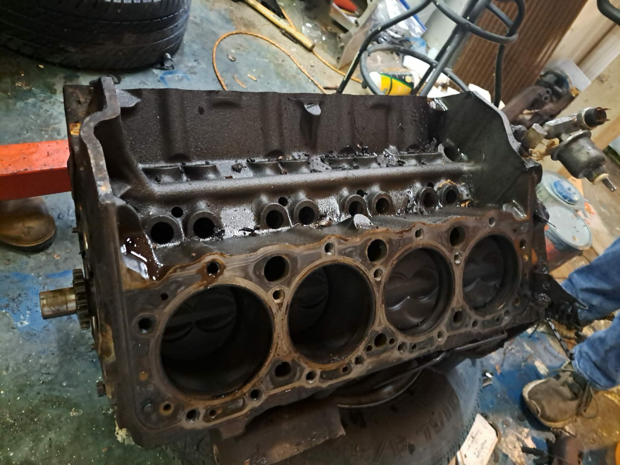

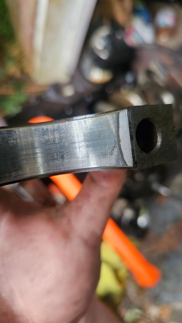

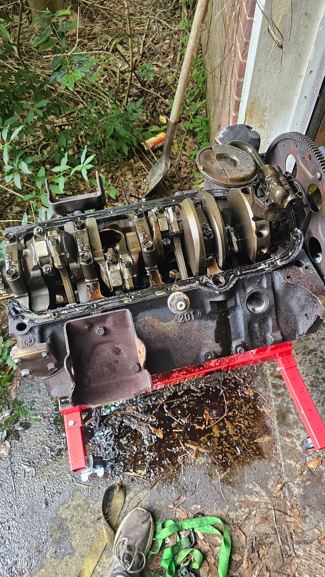

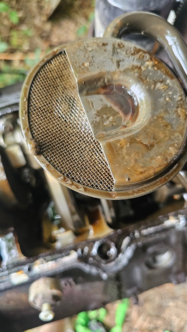

I've stripped the everything out of the block, and checked all bearings and cylinders. Camshaft bearings have already been swapped, and I'll do conrod and crank bearings tomorrow after I get 2 of my pistons back from the machine shop (I broke a couple skirts during dissasembly.)

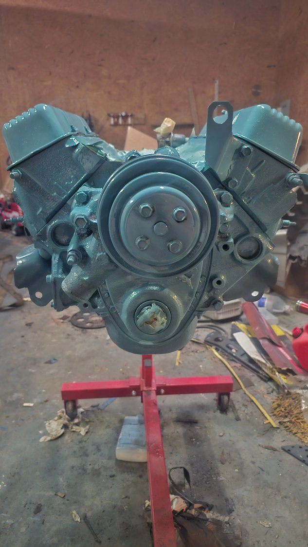

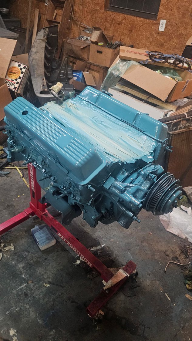

I'll get the engine buttoned back up tomorrow, and then I plan on painting it Pontiac blue which fits with the car a little better than Chevy orange imo even though it's a sbc.

Following up. I checked clearances on the crank and conrods. Evrything checked out okay, so I reinstalled the rest of the bottom end, got the heads installed, cleaned up the valve covers, and painted the engine.
Tomorrow I'll get to work on dropping the engine and trans back into the car, get the exhaust finished up to the headers, and start the first break in procedure if I still have time.
