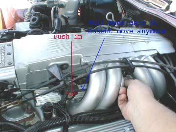

Are you looking for how to adjust the cable?
To adjust it after you have re-connected it, push the button on the side in with a screwdriver. While pushing in on the button, pull the black cable towards the firewal and release the button. Next take and slowly open the throttle to the WOT position. You will hear a ratcheting sound, this is cable adjusting itself. Release the throttle and you are done adjusting it.
After pulling the cable back and releasing the button, do I let go of it? Then get in the car and slowly go to WOT?

Yes, and if you want to, you can operate the throttle by hand while you're standing there. I do.

(The text in blue says "Pull back until it dosent move anymore")

You're welcome and the text in blue is correct.
