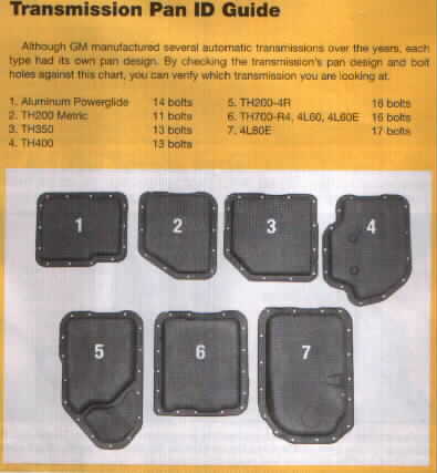

found this pic elsewhere on the board, thought it might be of use.........

As far as trans goes, that picture says it all. To find out about the engine, look behind the drivers side head, at the block. Use a flashlight, and get the casting number off the block. Take that to any internet decoding site and there you go. Some of them are as follows: www.nastyz28.com www.mortec.com
