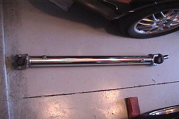

Nice driveshaft
This is the latest addition to my ride. It's an aluminum driveshaft out of a 2002 Camaro SS. I polished it as soon as I got it. It's almost too nice to put in. I highly recommend this mod if you experience high speed drivetrain vibration problems. The Ls1 driveshaft has a yoke damper on it to reduce vibration. It's stronger than the 1LE aluminum driveshafts. Notice the difference between the steel and the aluminum one

:hail: LS1 Driveshaft
I second the upgrade motion..
Oh, and is your car auto or manual, and what kind of rear gearing?
My GTA has an auto with 3.23 gears and my old steel shaft shook me silly..

It's a 5 speed manual with 3.73 gearing. I just got back from a high speed test drive and the vibration i had before has been eliminated. AWESOME INVESTMENT!! :lala:

dude, that looks sweet as all hell. I like the way you polished it up. Now you are gonna have to get under the car like twice a week and keep it that way.

yeah no shiznit. I won't be crawling under there anytime in this lifetime. That's a one time polish job there unless I decide to sell it later on. I asked myself "Why are you polishing this if no one is going to see it?" I can flip the car on it's roof down the highway and people will say "Hey nice driveshaft"

Unfortunately, no it's not. The LS1 shafts are thinner metal and fail more often than the third gen aluminum shafts. Dia. matters, but wall thickness in this case matters more. Sad but true.

Wow!!! That looks beautiful. I'd feel bad using it.

Awesome.
