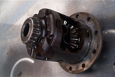

all it is, is the differential. no carrier, no axles. i was gonna use my stock axles and carrier as long as it would fit into my 1991 carrier. picture is not the posi i am getting, but an example
A posi/open/locker etc is the carrier. That's the part that holds the ring gear and has the side gears for the axles etc.
The 94 carrier will fit in your 91 and your axles will fit but you'll also need the 3 series gears. Since you're going to use the 94's 3.43 then there's no problem.

How I read it is you only have the carrier, you will need a set of series three gears to use with your stock axles and housing. Its all about interpretation (feeling like I am supreme court justice.)
well its the carrier, and the 3.43 gears. im gonna use my axles
Its a 3.42 gear
