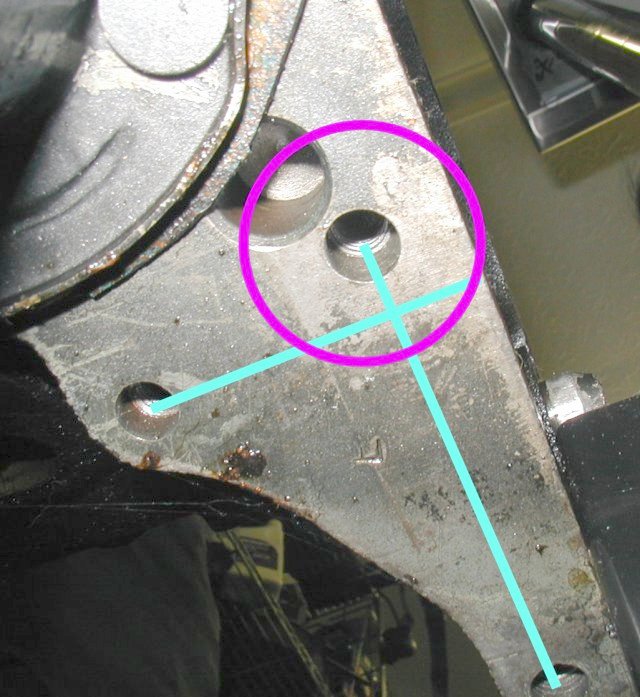

Here's a pic of a block that I drilled.
The hole circled in magenta is the new hole. You can't mount the T-5 starter without it.
This particular one is a 73 400 block. It came with only the other 2 holes (besides the circled one).
60s and 70s blocks that have the 2 holes along the rear of the block, don't have the hole circled in magenta. Instead, they sometimes have a hole exactly where the 2 cyan lines intersect. This is the hole that WILL NOT WORK for the T-5 starter.
Like I said, check carefully. With this pic, you might be able to tell if your block has all the holes that it needs, in the right places.
Notice that the bolt holes aren't just yerbasic standard bolt holes. They have an entry to them that's larger, which MUST BE a particular size. Starter bolts are special, not just yerbasic standard parts store bolts; they have short threads, and a raised area right under the threads that acts as a "dowel pin" to positivily locate the starter at the precise correct distance from the crank. If you lack the facilities to drill such a setup with precision, have a machine shop do it; it's cheaper than ruining a block.
