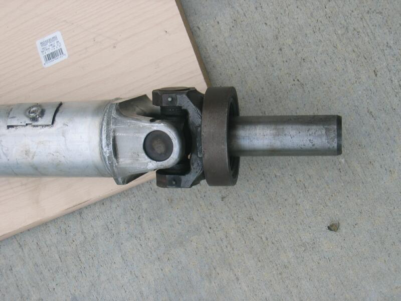

As for what to look for there are a few differences. IIRC, the 87-92 1LE driveshafts are 2.75" in dia., the 93-97 are 2.75, and 98-02 3". Try to find one from the later models that had the dampner on the tranny yoke - seems like it helps alot. The weight difference is marginal - even compared to the stock steel shaft, but every 1lb of rotating mass you lose = ~7hp. Try ebay also - that kinda stuff is always abound.
Thats the info I was looking for. I'm gonna hold out for a '98 or newer. Yard wanted $100 for the '97. I guess it's a back-up if I can't find a newer one.

So off to the junkyard I went. Got a DS from a '97 Camaro. It has a dampner on the yoke end. Not sure if it was really a '97 or not. Don't really care. Pic is below. Let me know if that's not a dampner but it sure looks like one to me. And it was only $100. Brought it home, cleaned it up a bit and put it in. OPTEST SAT.
Now the bad news... The vibration when the RPMs are up is back. Not as bad as before, but back. I think the DS vibration was covering it up and the rubber mount just didn't transfer the vib to the frame like the poly one did. I get the vibration really bad in 3rd gear, but is noticable at about 85mph and up in 4th. Since it is RPM related (after about 2700 RPM), It has to be engine or trany. Right? Reading the other post, I guess I have to pull the trany out and run the engine up to speed. The guy at the salvage yard said the 3rd gens have inherent problems with out of balance torque converters also. True or not?? Don't know. Would be a good reason to buy a TC and shift kit though.
Let me know your thoughts.
