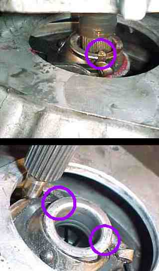

Sounds like the clutch isn't disengaging. Also sounds like maybe this is your first time putting a stick shift car together. So I'll post my famous pic.
Which way did you put your throwout bearing on the fork? One way will make the clutch fail to release, and cause the transmission to grind on shifts and all of those things, exactly as you described. The other way is of course the correct way.
Also, what kind of a pilot did you put in your crank? Bushing, or bearing?
Attached Thumbnails Do I need a T-5 Rebuild?-c-old-d-drive

no, i never put the clutch in this car, the previous owner did. I guess he may have installed it wrong. I am replacing the clutch tommorow and ill see what happens.

Well, the answer to the riddle is, the top pic is WRONg, the bottom pic is RIGHT. Note the little flat spring thing that's riveted onto the fork; see how its little ears are up out of the throwout's groove in the top pic, and how they're inside the groove in teh bottom one.

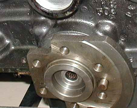

The pilot bearing or bushing goes in the end of the crank, and supports the front of the transmission's clutch gear. Without it, all sorts of evil things happen; up to and including total destruction of the transmission. ALWAYS replace it.
Attached Thumbnails Do I need a T-5 Rebuild?-c-documents-settings-rbenjami

Do you have to machine the crank for a bearing as opposed to a bushing?

No, taps right in and is much better!

well i took your advice and replaced the clutch, pressure plate, throwoutbearing and had the flywheel resurfaced (Centerforce Dual friciton kit) and i noticed the old clutch was very worn and the throwout bearing was installed incorrectly.
