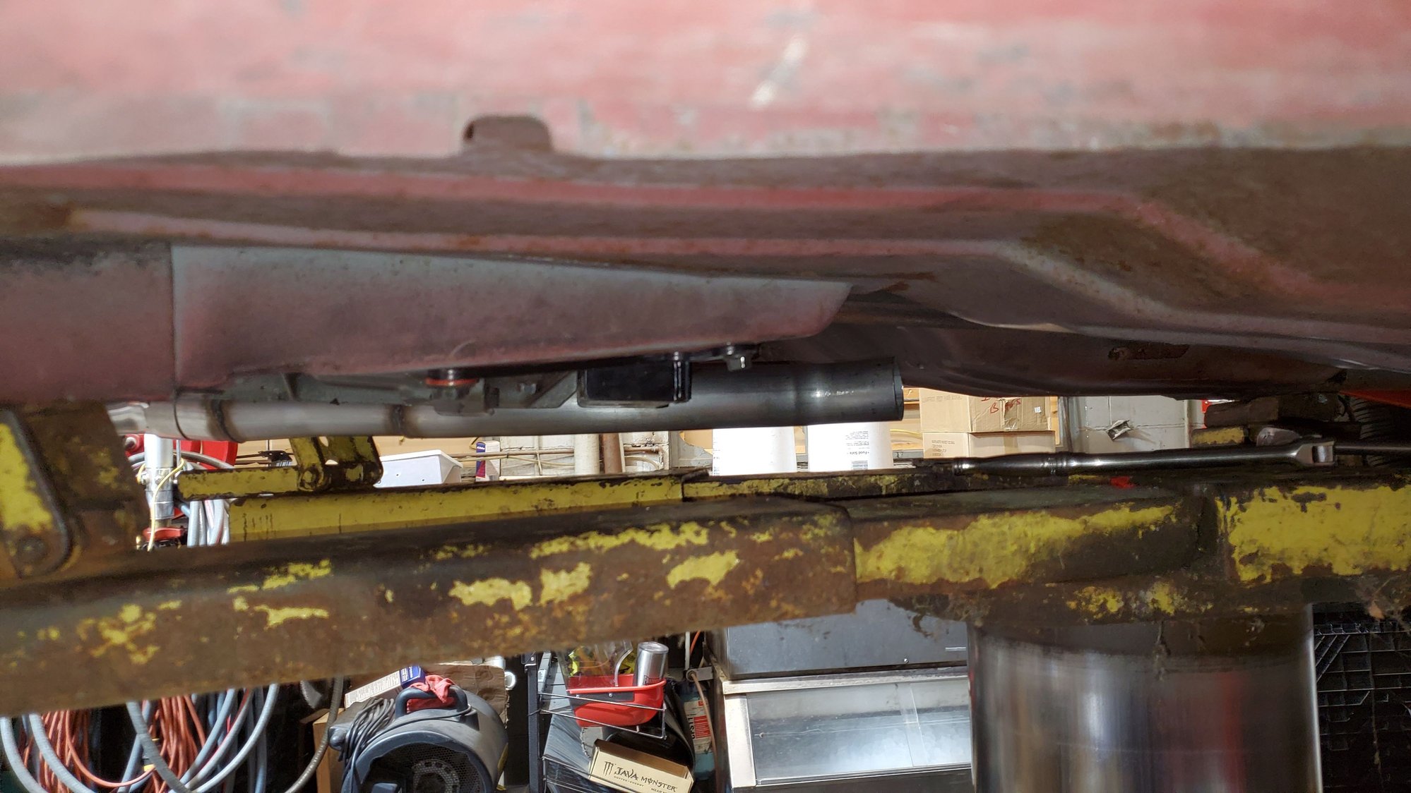

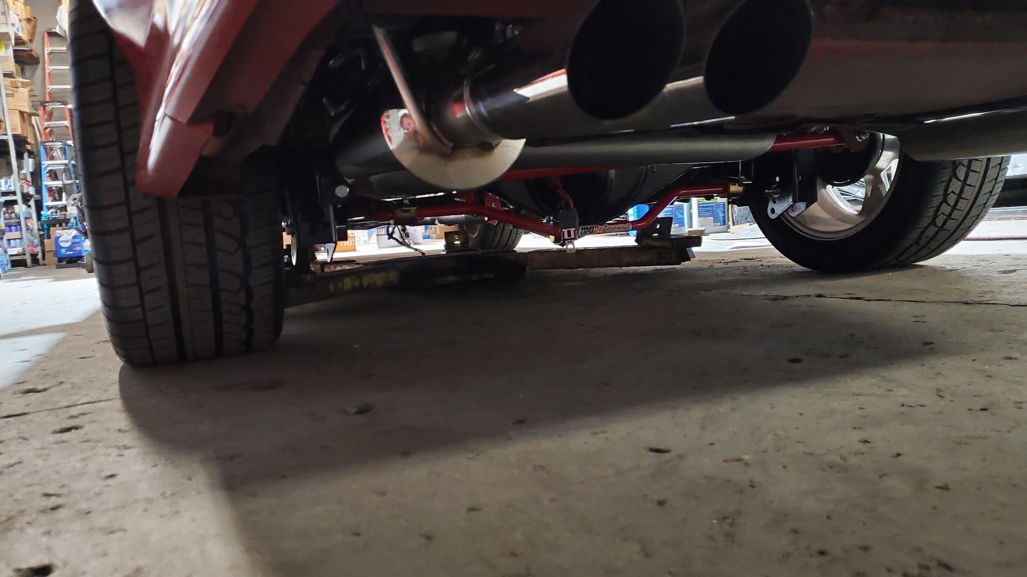

I have this one and I can vouch for it. Here is a photo of it installed. Sorry I don't have any super direct pics but went in without too much drama. I painted it myself but if I had to do it all over again, I'd have them powdercoat it instead. Keep in mind that if you go with a housing/axle package like this you will need access to a press. I saved well over $1000 going this route so definitely worth it.
All you need is a center section which they can supply or you can source separately via junkyard or new from someone else. I'd recommend going TruTrac diff if you are going to use it on the street.
Old Jan 4, 2020 | 11:59 AM

How does the unit fit? It looks like you got their fabricated section? What torque arm are you running and are you having any troubles with the torque arm hitting the floor pan?
good question. The rear in and of itself fits well. I am running a BMR adjustable torque arm and you have to grind off a good amount to get to the inside-most holes on the BMR piece. Once you get that part done there's not a lot of drama but a lot of it depends on your crossmember. I am using the hooker Blackheart piece. FWIW I'm using a 3" aluminum driveshaft as well. I wouldn't be comfortable going bigger.
Anyway, once you get your (BMR) torque arm installed correctly there shouldn't be any cutting of the floor. At the worst maybe a BFH or a leverage pipe to bend it over a little. With a BMR torque arm relocation crossmember it cleared fine. With the Blackheart crossmember it was closer to floor but I added a little clearance for good measure
