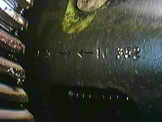

As stated, I have searched and to no avail, so WTH kind of carrier is this thing???
The only markings I can find on this thing is J 5 -><- 10 352
Done a search on Google also, can't find a D**m thing. Any idea?
And yes I know its a series 2 carrier, but this thing had been upgraded with grade 8 bolts, but they stuck back in 2.73 for some odd reason. Nearly no wear whatsoever, didn't whine when the 86 was still alive.

What a piece of crap picture. Lemme guess, camera phone?
People have gotta stop using those POS's for taking pictures. Yea, they "can" do that, but they're so heinously bad that you might as well not even bother. Geez I hate that...
uhh, anyway, ahem, on the topic here, what did you get that carrier out of?
Can you get a clear picture of the "left" side from your view there? With a real camera?
I don't want to put any opinions on the line until I see a picture with some clarity, it just looks like a posi carrier of some sort now.

Got any that aren't blurry?

isn't that an eaton?

LSD of some flavor...

Does it have clutch disks or cones?

Eaton
It does seem to very closely resemble the eaton. Still pretty hard to identify with the quality of pics though...
At this point i would say 90% its eaton

It's not an Eaton.
It's an old stock Auburn one; looks like 2 series to me, by the shape of the ring gear flange (flat, not cone-shaped).

For comparison's sake, here's a couple of other Auburns.
The one on the left is a stock 2 series Auburn; the one on the right is a 3 series hi-perf. Note the difference inthe shape of the 2 ring gear flanges, and the additional springs in the one on the right.

Ahh yes.
Now i can see, due to the crappy pics i couldnt see the little 'notch' until i was looking for it

Lets hope it will hold up to around 400hp, figured the axle would break before this carrier will. Gotta get a ring gear spacer and its gonna have 3.73s paired with it. Thanks for identifying it, I have another carrier that is stock as well, does not look anything like this one. That rear end is trashed, so this is the better of the two.
