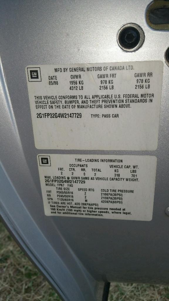

I told him what you advised... He bought the car 110k... He is parting because he put a 370ci in there and mechanic cracked a head because there was a screw in the cylinder. The mechanic wouldn't replace the damaged items and that is why he is parting at 144k just for that FYI...
He provided pics of the very front of the rear end that I will post for you below.
Also he sent me the assembly line date by picture from the interior door showing a 5/98 assembly date. I wouldn't put it past GM to have used left over rears from 98 in a 99 like they dos 9 bolts into early assembled 1990 irons and formulas. I had a 90 iroc with a factory 9 bolt?!?!?
Your thoughts, Big?

As far as I know the Torsen was used starting in '98 when the LS line of engines went into the F body cars. If this was a left over '98 is still should have had the Torsen. Someone might have swapped a '93 to '97 rear end into the car at some time. Anyway, no matter what year it is, that's an Auburn, not a Torsen.
