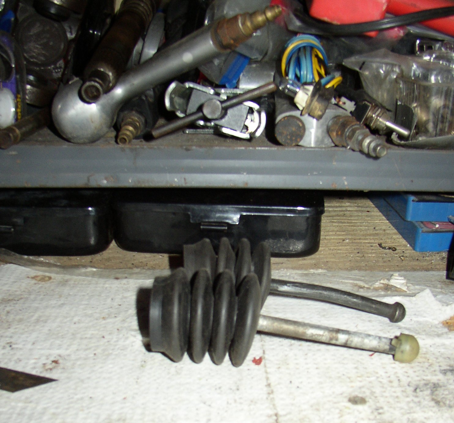

As long as the seal on the that slave is good...... you might still get some use from it. Install / swapping a boot and rod on the slave should take about 5 seconds.
I'd stick the slave you've got there into a garage drawer as a back-up. It's not all that uncommon to find the rod bent causing the clutch not to engage properly. I say "not that uncommon" because I've owned less than a dozen T5 cars and have had 2-3 bent rods. ( This one is from a T56 )
