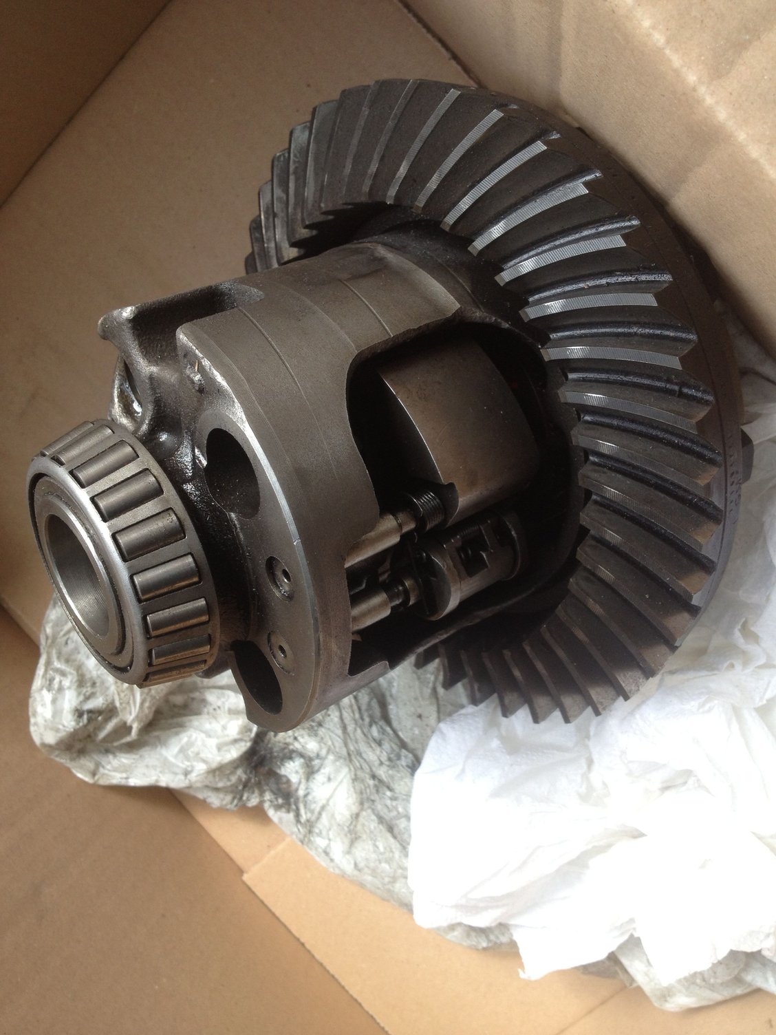

Hello, everyone.
Firstly, I want to warn everyone who is reading this post, because I'm a total newcomer in 3gen society, so don't take a hard on me
I'm driving 5,7, 1990 Camaro, usually only on weekends, because the gas in Europe is freaking expensive
Yesterday the diff started to kick out crazy noises I'm guessing that some sort of an axle has broken. The previous owner already warned me of it. So the day has come, and I'm looking for a new one.
Could anyone please help me to identify this differential I'm having? (all I know is that the cover has 10bolts and that it's automatic locking) :
Is there any chance to order Eaton or Torsen parts somewhere, with shipping to Europe.
Maybe I should get a used one?
The situation with spare parts in Western Europe is beyond critical, so any help/advice will be appreciated.
Thanks in advance,
Samuel

That sure looks like a Gov-lock. Probably had an Auburn to begin with, not that the stock Auburn is anything fantastic, but the Gov-lock is about as durable as two gerbils holding hands. Any carrier that's not another Gov-lock would be an upgrade.

http://www.quickperformance.com/GM-7...Bolt_c_78.html
This is one of the best places to get rear end parts. I don't know if they ship to you or not, but it's worth checking. They also have a ebay store.
The differential that you have is an Eaton Governor Lock. It's probably the 2nd worst limited slip differential that you could have. The Auburn would be the worst. I recommend replacing it with a Eaton Posi, Eaton Truetrac or a Yukon Dura Grip.
I don't see anything in your pictures that is damaged and I don't see any signs of welding. I think you need to look some more and find out what the problem really is.

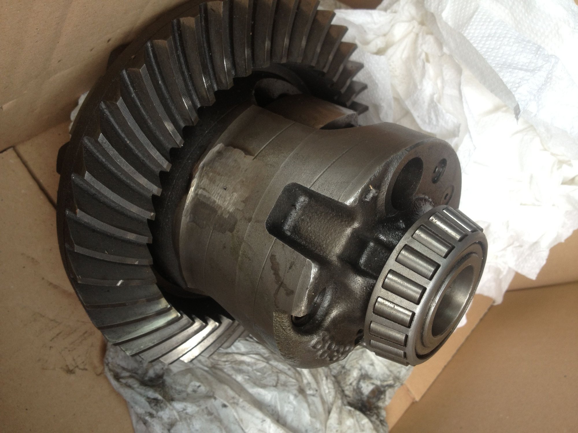

IS that ground down section stock? Maybe a casting grind or was it something welded and ground down

That's an Eaton Gov-Lock. Also known as Gov-Bomb, Grenade-Lock, etc. There is no differential that could possibly be a worse choice for our cars.
It probably came out of a S-10 truck (the little "mini" pickup that GM makes). It was originally designed to be put in light military trucks that were intended to be used exclusively off-road, at low speeds, and had very small under-powered engines. It works somewhat OK in a situation like that.
The way it works is, it functions as a completely open rear (no locking between the axles of any kind), as long as the difference in the RPMs of the 2 axles is below about 150. The axles are then free to turn independently of each other. Then once that threshold is exceeded, those little springs and weights (a "governor" of sorts, which is where its name came from) operate, which locks it up solid. The problem in a powerful car on pavement is, that if one-wheel-spin ever starts, then when it locks up, if the tires have any traction at all, it does so with such violence and so suddenly, that the whole thing literally EXPLODES. The entire carrier disintegrates into shrapnel. It can do this with enough force to send pieces through the cover. In fact there's a photo running around somewhere of one that shot pieces into the gas tank (which is right in its line of fire).
I included a typical photo of what happens.
The grinding looks to me like someone wanted to hide something about it for some reason, or, somebody had to do something hideous to remove the little bolt that holds the cross shaft in after they broke it trying to take it out.
Getting a new Eaton NOT a Gov-Lock, Yukon, Truetrac, or Torsen would be the way to go. Avoid Auburn... the stock posi for your car would have been an Auburn, and it's pitiful, so don't bother with a stock one. And of course, don't fool around with "repairing" that steaming bucket of excrement that you have now.
As far as used ones, the only one I can recommend is the Torsen that came in 98-2000 Camaro/Firebird V8 cars. (LS1) Don't get a stock one out of a 3rd gen like ours, or a 93-97, since those are all Auburn.
Wow! I completely missed that! Someone has welded the cross shaft in this thing!
How did you get the axles out of it? Does it still have c clips on the axles? Yes, you need to replace that!

I believe someone mentioned this:
We're all thinking the stuff in your photos is what came out of your car's rear end. Judging by your last comment
when I'll open the cover
it's not. Telling us what you REALLY have will help us point you in the right direction.
If you don't already have that crap in the pictures up there, DO NOT buy it!!!!
