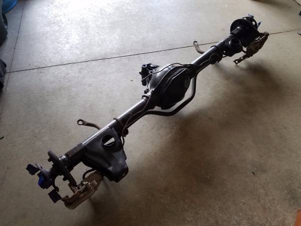

I'm supposed to be going to pick up a BW 78 rear end tonight, and I just wanted to get a few things sorted out and look for a couple more opinions on this for me.
I dont have a lot to go off of on what a good price is, as well as if the swap is really even worth it.
I have a 91 with a 10 bolt, with drum, non-posi, and 2.73s. Bottom of the barrel stuff.
My first question is: Is this upgrade worth it? I keep hearing these stories that the disc brakes are more of a problem than anything, and
Next thing is : The rear end is reconditioned (blasted and painted) but without gears in it, so I expect it will cost another couple hundred to get to the point where its ready to go in. What kind of cost should I expect to have the rear built for me? How rare are these things these days? Should I hold off and try to find one in a junkyard, or a different CL add assembled already?
Hes asking $300, but said he would take $200 tonight. I think this seems to be a very good price. It also includes wheel seals, diff gasket, and 2 sets of gears.(2.77 & 3.27) Which leads me to my last question: Isnt 3.27 a little on the tall side for these cars? Or is it a decent upgrade from the 2.73s I currently have? Also, I dont think anything shorter is available without a carrier swap, correct?
What do you guys think?
Here is the add itself.
Selling a Borg Warner 78 rear end for 3rd Generation Camaros/Firebirds (1982-1992). It has rear disc calipers, sway bar, 2 sets of gears (2.77 & 3.27). I believe it has a series 2 carrier. Included is a new cover gasket and right axle seal...both GM. I bought this years ago and never got around to building it.

Definitely a great deal & that unit has the later (PBR) brakes.Which are not the ones you've read horror stories about.The 3.23 & (numerically) up posi's require a different carrier, but 3.27 is ideal for these cars.

78 is what Borg Warner calls the 9 bolt rear end the only thing to caution you with it is if it's a 2 Series posi carrier 327 gears will not fit

Im a little confused about it honestly....
It came disassembled. Everything is there, but even after scouring the net for quite a while I cant seem to find out exactly what I have.
It came with a carrier labeled 0578, and 2 sets of gears which only 1 will work for the carrier I have. 0575(2.77) and 0578.(3.27)
Now logic tells me that if the carrier is labeled 0578, then the gearsets I need would also be labeled 0578(3.27) correct? I cant seem to understand why it came with mismatched gears, or even which would be the right ones to use?
It would all be cut and dry, except, I cant seem to find an answer to 0578 thing. I think I have been reading that the 0578 carrier could be used with the 0575(2.77) gearset, and that the bearings are what make it different, so I am a little confused....

Yeah Borg M78 as another poster said.
They are the PBR Aluminum brakes too so thats a good thing.
DO you have any idea about the carrier numbers?

And to answer my own question earlier.
Im almost certain that the 0578 carrier stamp means its a series 3. It had series 2 (0575) gearset installed on it with shims, but the carrier itself is a series 3. If its stamped 0578, then it is in fact a 0578.
