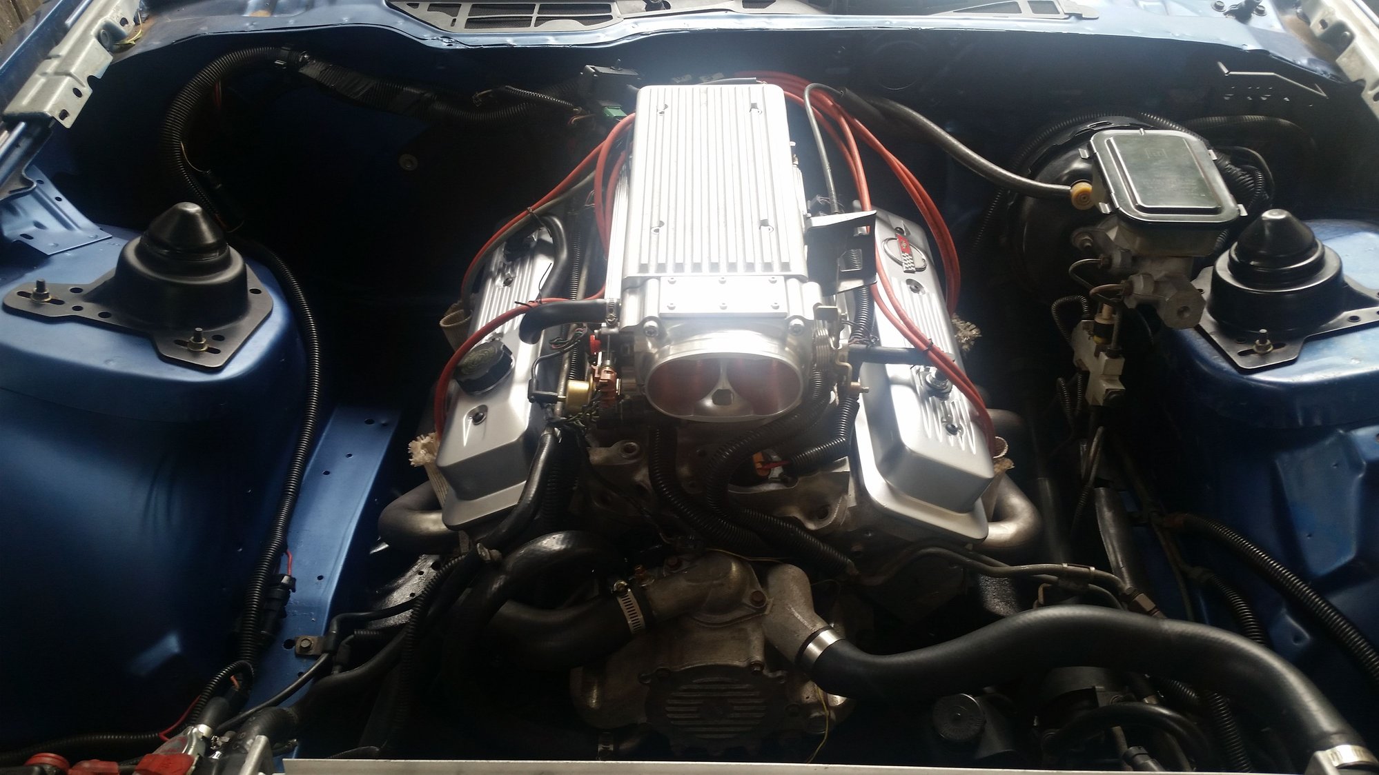

actually current engine is lt1 swap am still using stock 3rd gen ecu and running distributor
my current setup
you are correct on the other factors theres noway to know tranys past history, 1993 trany i found is out of a formula with 63k for $550 i know pretty low for age but have seen odometer for myself
