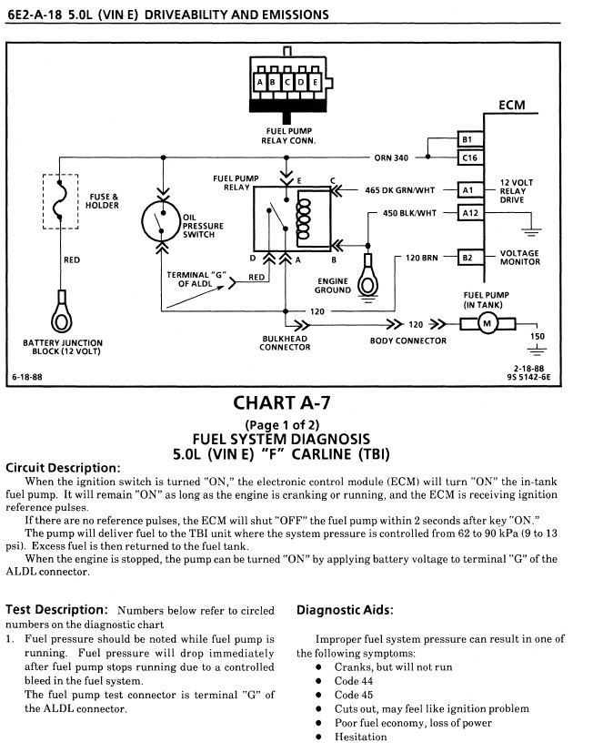

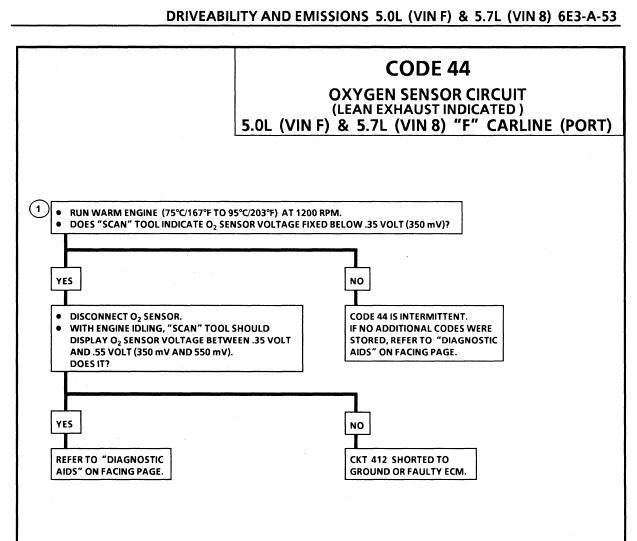

I checked and it gives me a code 44.
I originally thought it could be the map sensor or maybe even the 02. But then I got told it sounds like a torque converter issue so here I am lol

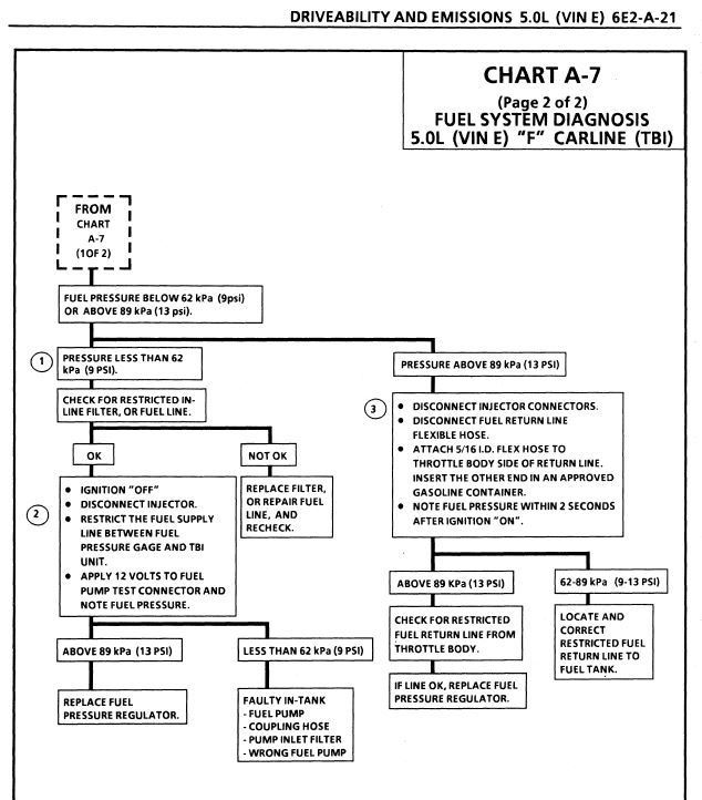

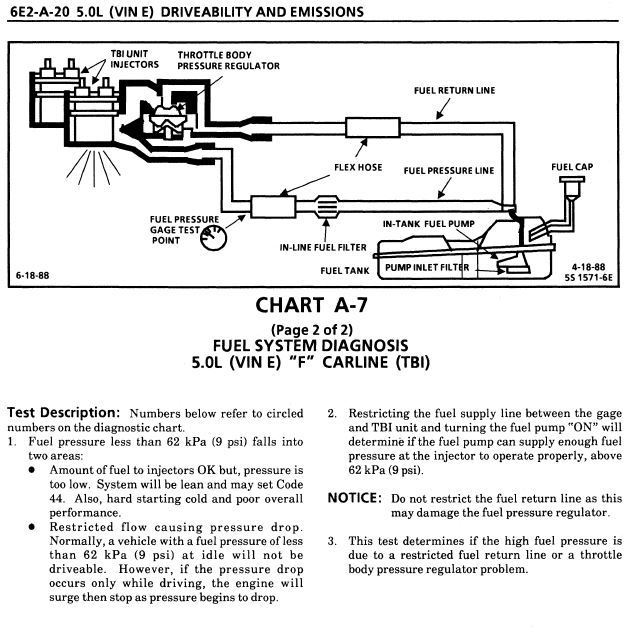

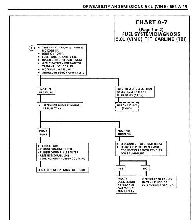

Time to investigate!

Thanks Tootie.
I'll have to pick a battery up for my multimeter.​​​​​
To rule out the map sensor I put my jumper in the a/b ports while the car was running and according to the cel flashes its running rich(on more than off). If i unplug the map sensor it stays rich and starts to idle rough. I think it might be the 02 or ecm at this point according to the chart.
I'll check back once I test the 02 sensor
