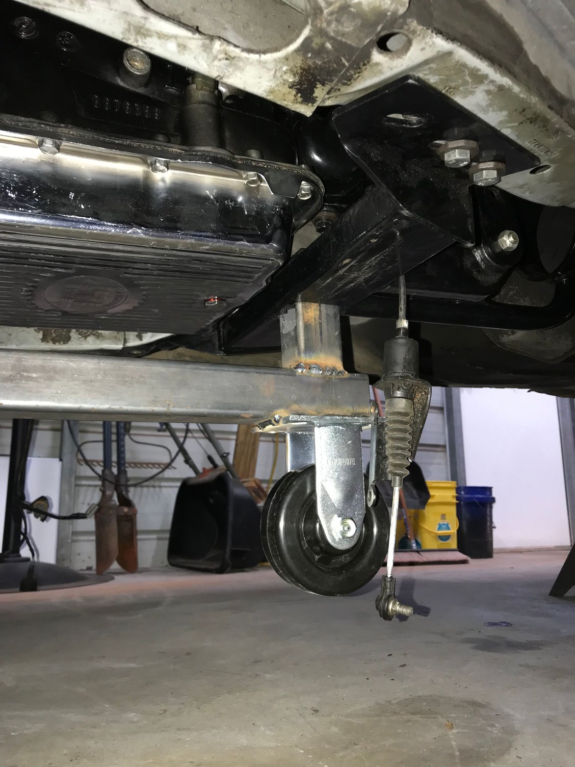

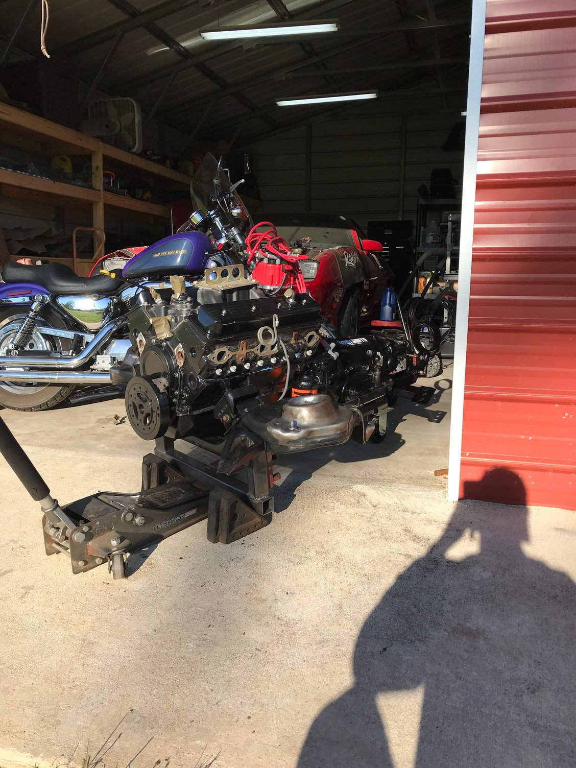

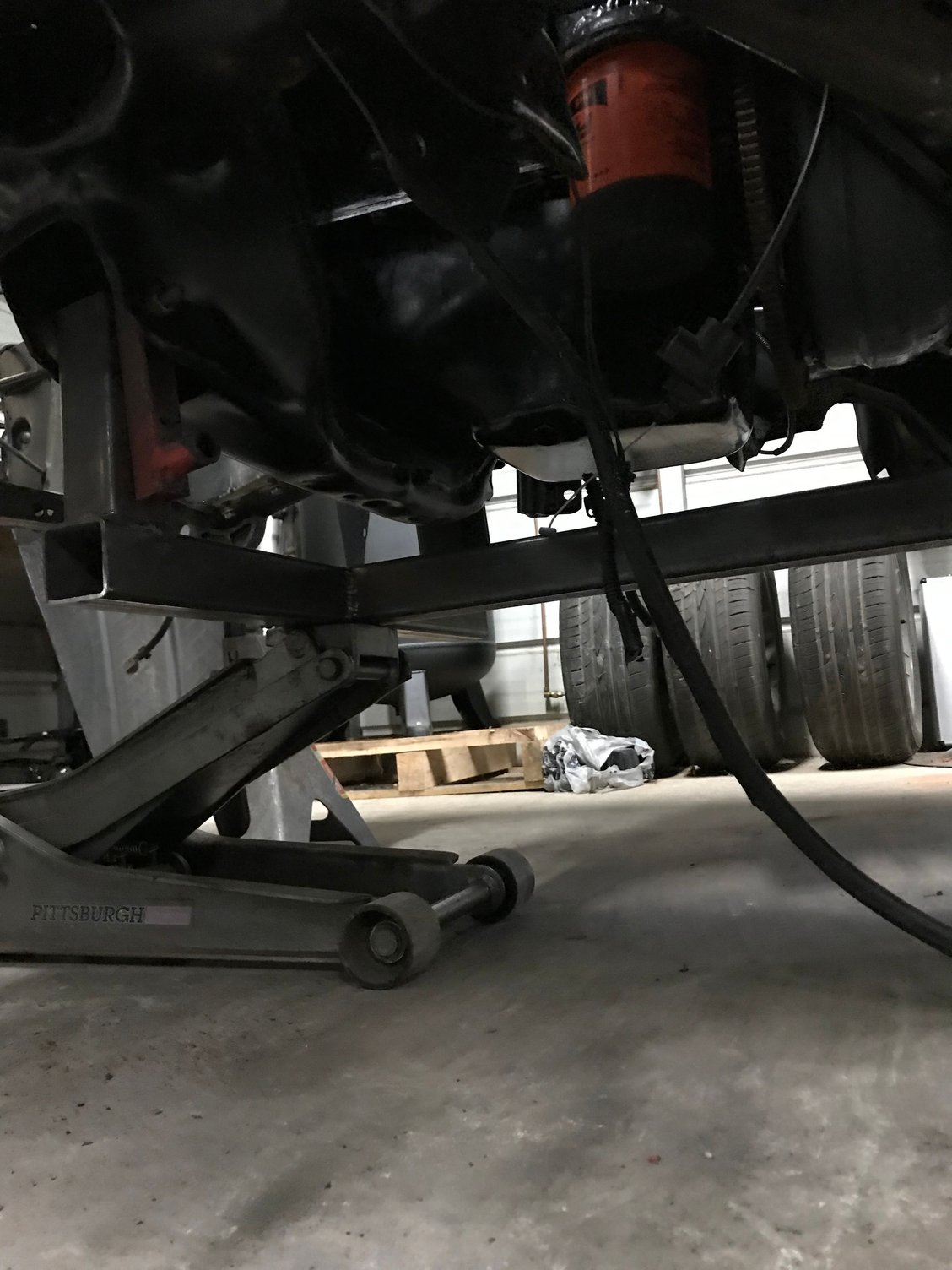

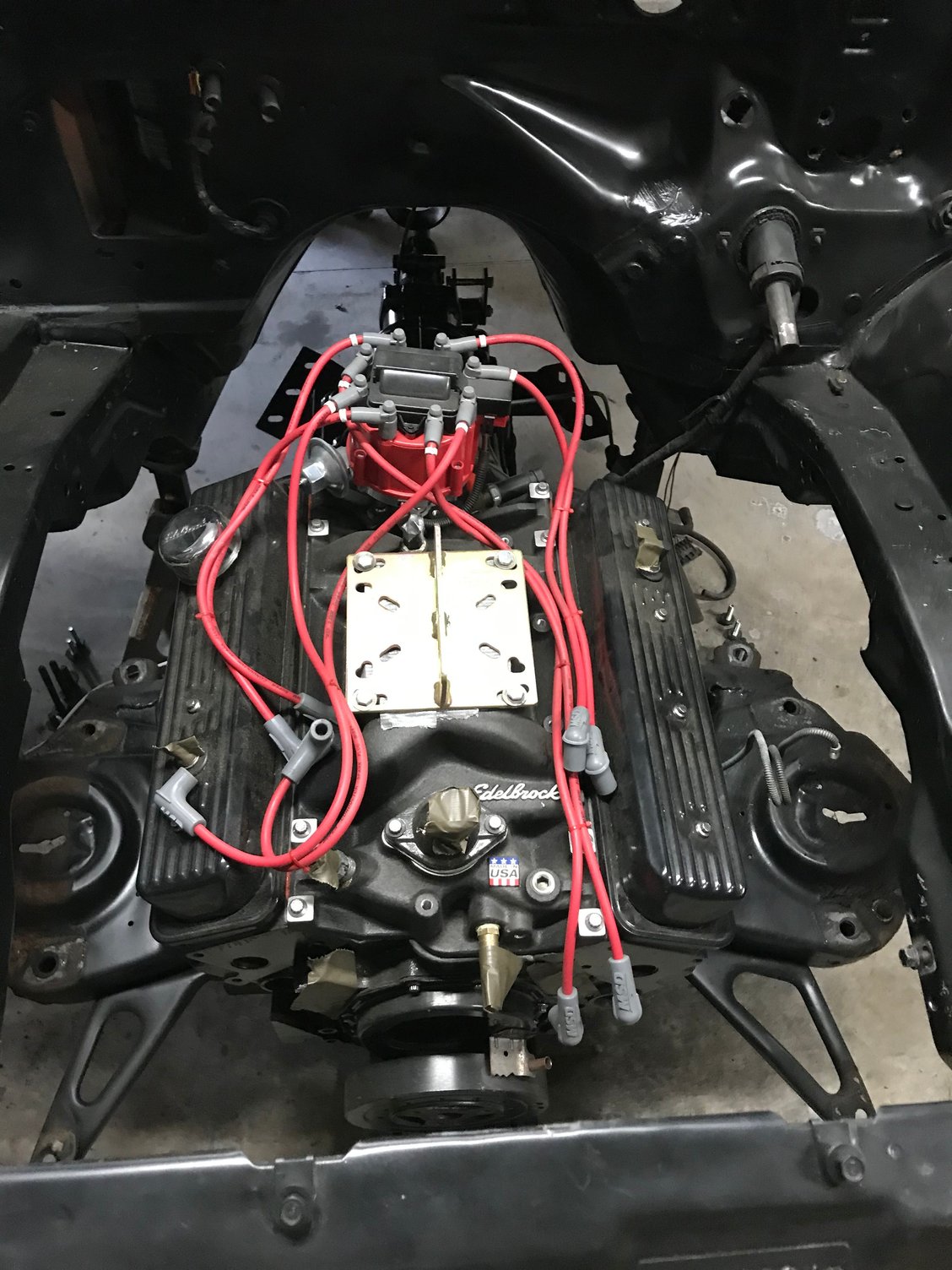

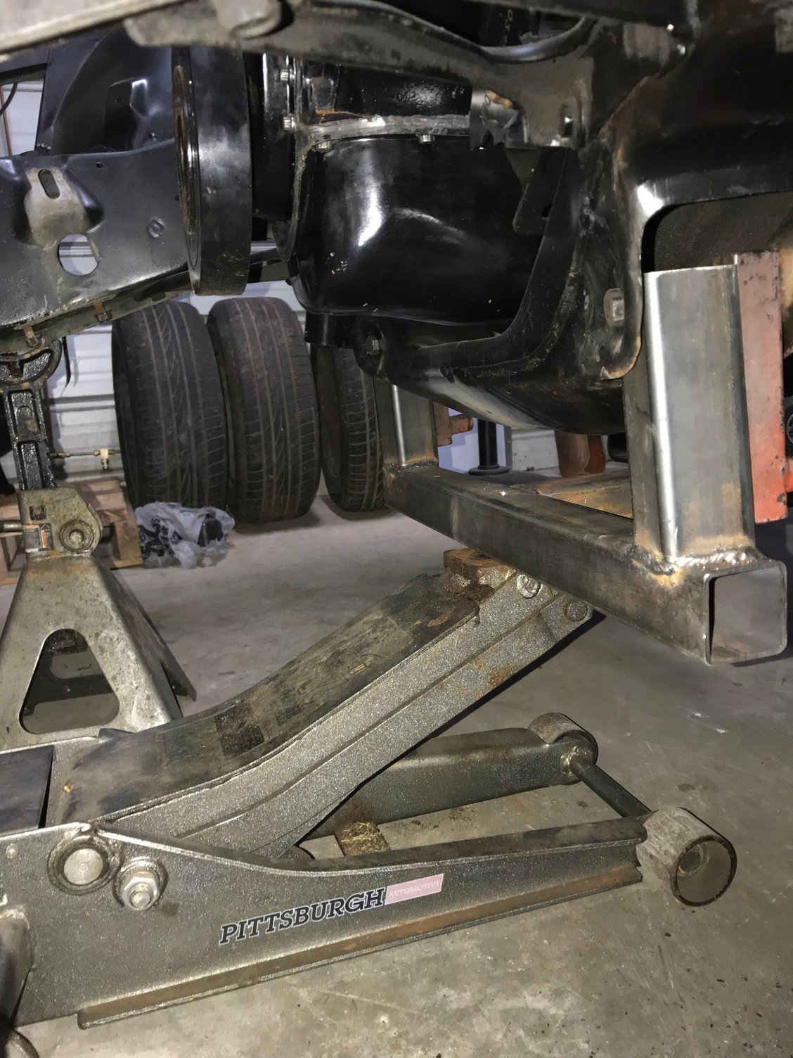

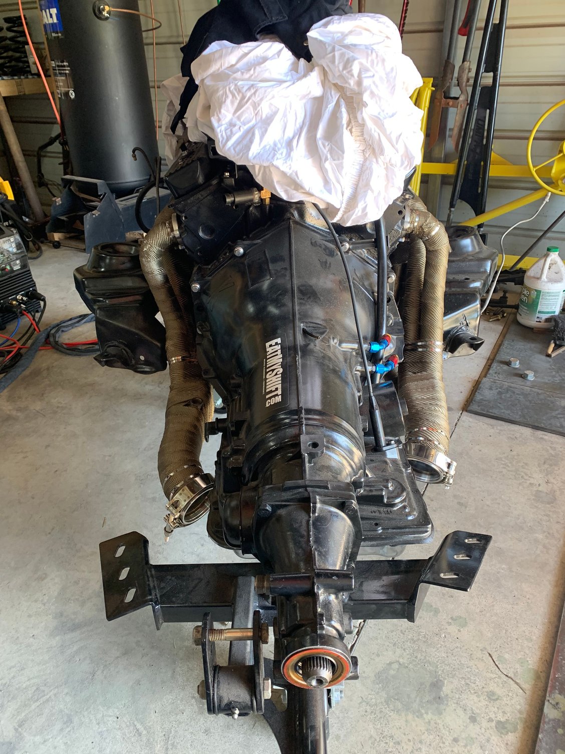

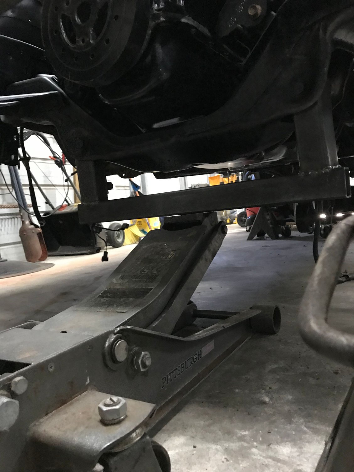

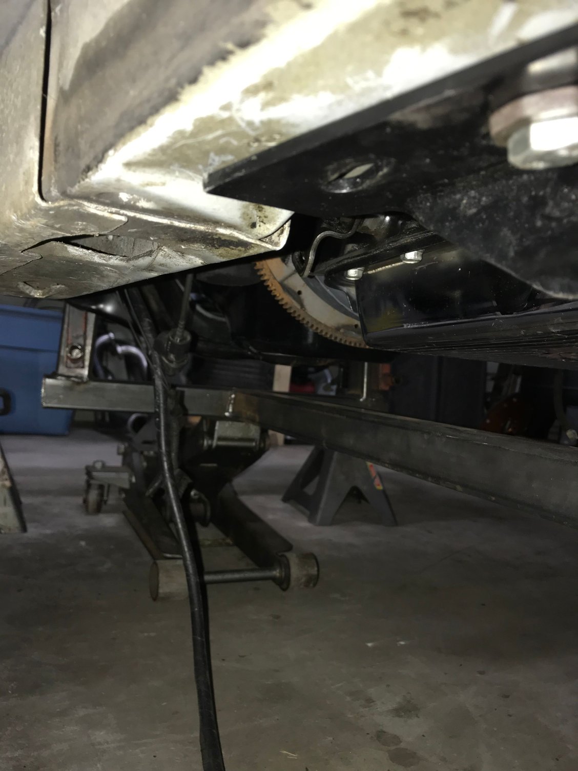

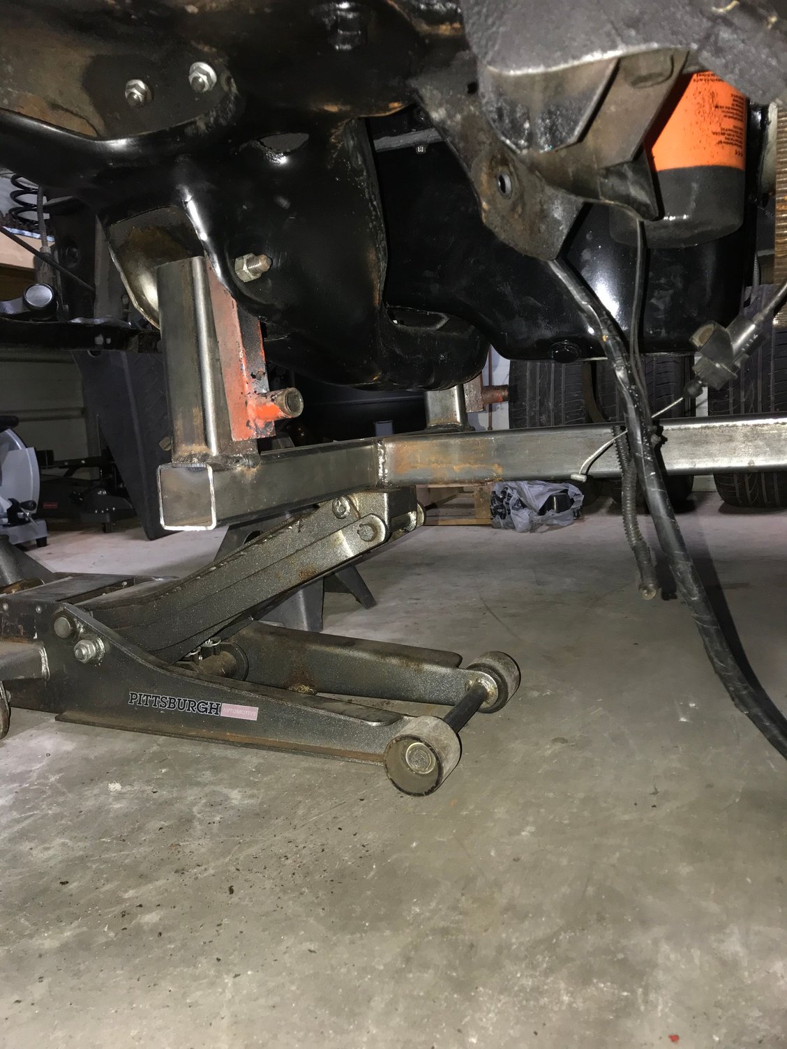

This was an idea I came up a few years back.The only thing is I wish I would’ve made it taller, but it works really well “especially with headers installed. Bolts to the floor Jack and you use the 2 post lift in conjunction. I can hard mount the engine and tranny in 5 minutes by myself. The photos aren’t in order, feel free to use the idea.

I only shared because someone said the were doing suspension upgrades in addition to engine work. The coil spring and strut still need to be removed for this process and they are still dangerous to deal with.
